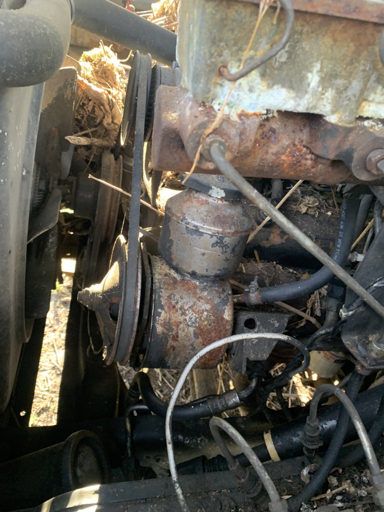

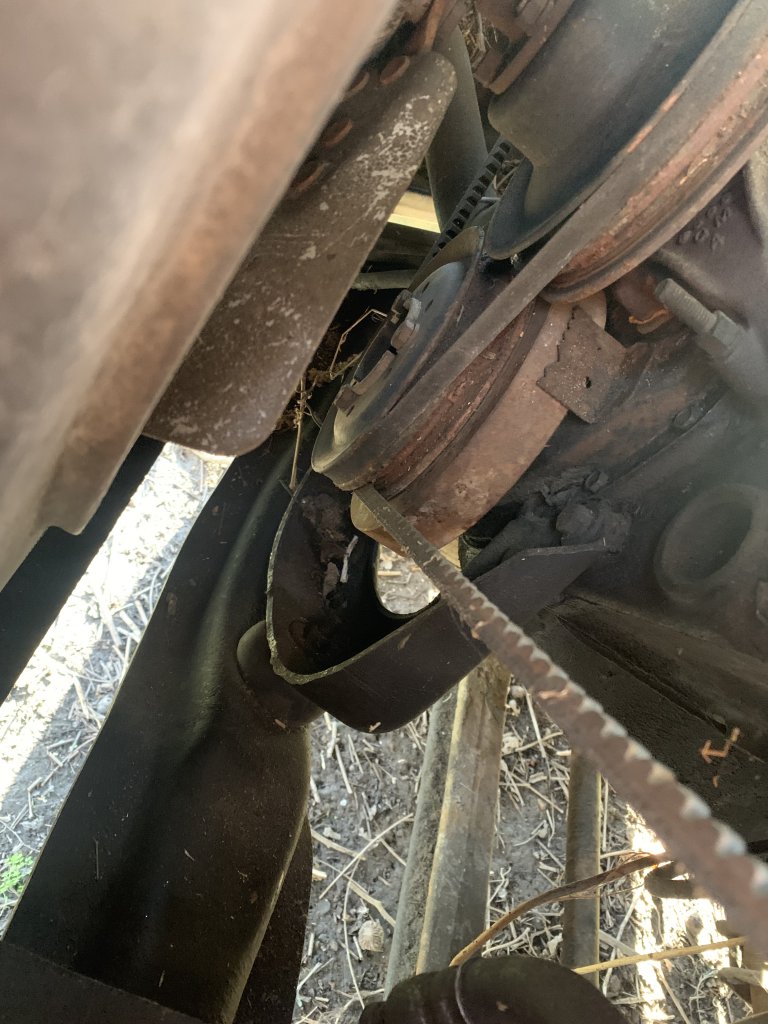

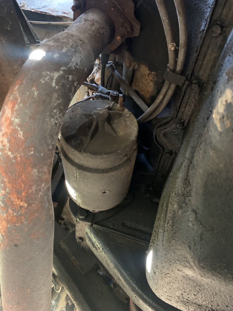

Factory center dump 1985 350 exhaust manifolds. Note the 1960s style power steering pump and starter? Or the 1955-? 265/283 front mount? Again, factory installed 1985 parts…
Do you “really” want to backdate your truck “that” far? Just curious… This is the donor 350 for my wife’s 85 C10 swb to get rid of the stock 4.3L V6. It is still in the parts roach (C60) for a reason…
