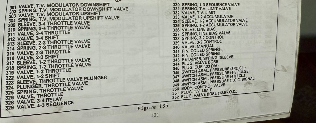

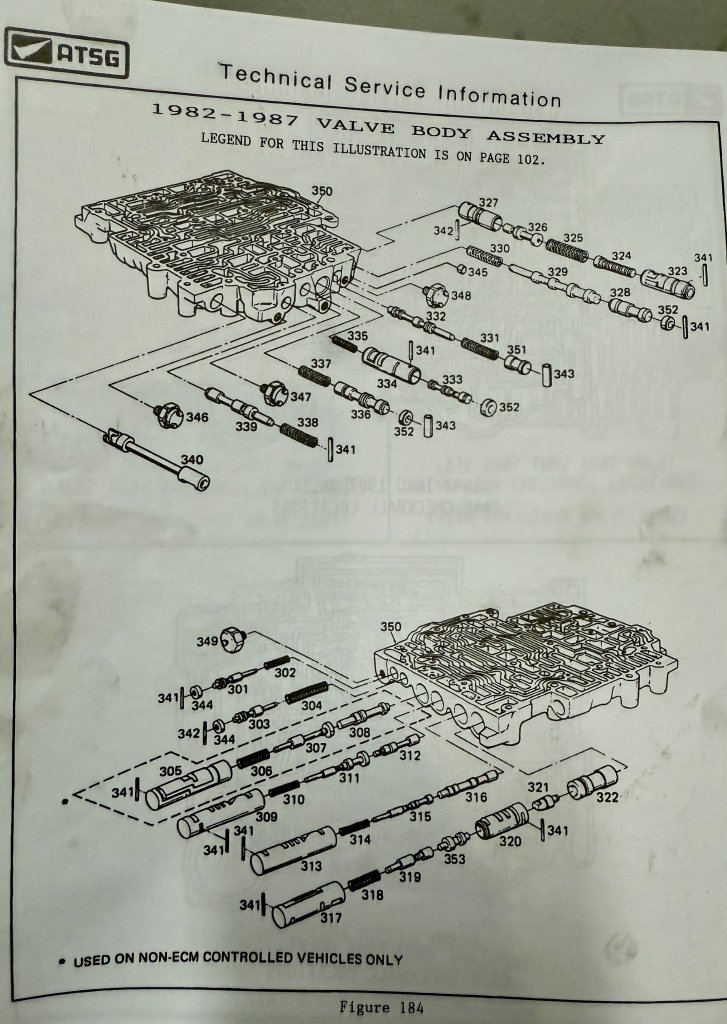

Sorry, didn't see your initial posts. 82-86 did have a 2nd-4th TCC apply strategy however in 1987, they went from locking the TC in 2nd gear (some models) to only have it lock up in third and 4th. So it shouldn't be locking immediately upon shifting from 1-2. From what I can recall, everything is electro-mechanical in those earlier years so a bad pressure switch can certainly be a possibility. Here's a valve body diagram and legend which shows all the pressure switches found on your valve body. I believe you should only have the 3rd and 4th clutch pressure switch but there were a variety of configurations in 1987 as that was a big change-over year for the 700r4s in many respects.
In your case, I would purchase all of the pressure switches that the valve body takes and simply return the ones you don't need. This way, you're not stuck. Also grab a new filter and pan gasket (no rubber or cork) as well.
