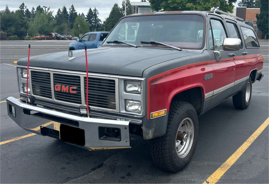

I know it’s been talked about for years, but I figured I could be very specific. I have a 1986 GMC Suburban K1500 with an emissions 350 sbc. I know Vortec is a good way to go, but what can I do to it without going to heads. Cam? Intake? Etc. Vortec stuff will put me over $1k. What can I do to improve horsepower for less? And I do plan on removing all the emission accessories and garbage to clean it up.
Also im running a Edelbrock 1406. I don’t want to go back to a Quadrajet.
Ask any other questions and I’ll answer.
Pic of rig for reference
Not to over simply it but, Headers, long tube and cam. then gears. 99% of other add ons will do very little at the DD rpm. There is a huge difference in wot HP vs driving builds
