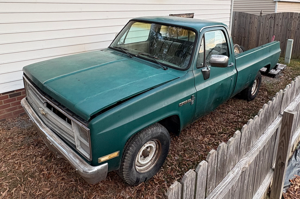

Can anyone tell me what the paint code is on this '86? (For some insane reason, the PO scraped the SPID off the glovebox. :confused:)
I've always called it Forestry Service Green. But I'm pretty sure this wasn't a Forestry Service truck, so I'm not really sure what green it is?
I'd like to have a couple spray cans mixed up to do some touch-up. So I'm assuming they'll ask for a code.

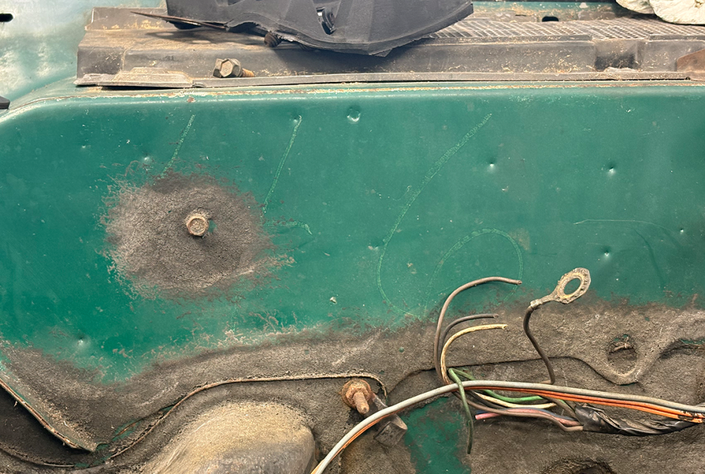

Any grease pencil markings on the firewall? Sometimes they will scribble the paint code along with some other options.
K
Wow, Keith. Good call!

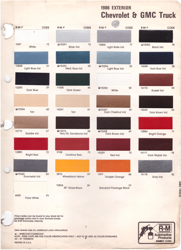

Went out and found this.
And did a bit of googling and found the 1986 paint codes.
Looks like 46 it is! (Although it looks waay darker on that swatch.)
