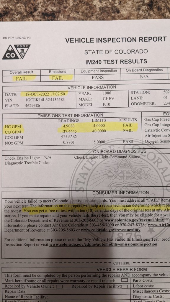

Numbers are reversed. CO 4.9% HC PPM 137
CO should be in the 1-1 1/2% or even lower with functioning cat and air pump. With the air pump disabled [pinch the hoses closed] it is likely very rich. Lean it out, bigger metering rods. Do a lead drop idle mix.
Don't be concerned with the HC yet it should be lower after those adjustments.
They're not switched, they are all measured I grams per mile not percentages or PPM.

Thanks for showing your paperwork, but still @fast 99 gives good advice. I also think your plan to tune it up is a good idea, don't forget to check the timing.
Air pump and cat should be functional, a functional EGR will REALLY help off idle emissions, but if it's gone and / or the ports in the manifold are clogged it's likely you can get it to pass without it.

Washington used completely different testing standards, PPM HC and percent CO. Sorry for the confusion. I just don't know how high those readings are. The basics still apply, high CO rich, high HC everything else. Do a tune up if needed and lower the CO by leaning the carb out. Many times, high CO will elevate the HC slightly.
Do check that the air pump and cat are working. Combined they are extremely good at emissions reduction.
