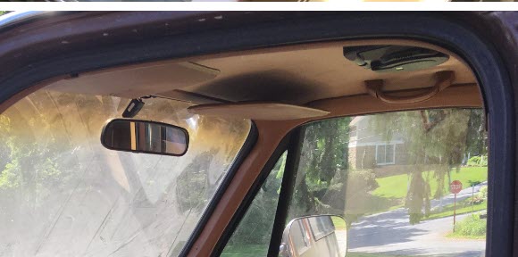

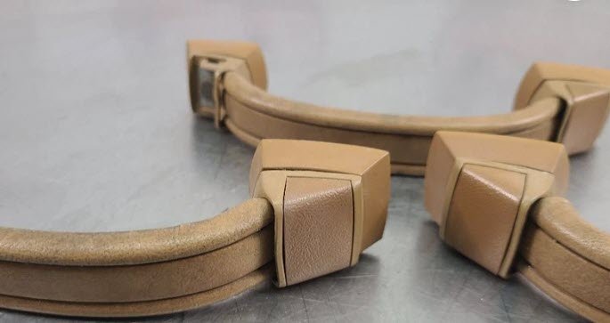

I'm looking to add ceiling mounted grab handles like these https://www.ebay.com/itm/297085982446 to my 83 Suburban which does not have any. Does anybody have photos of the mount points in the ceiling. Presume I'll need to weld something up there.

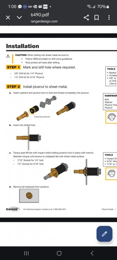

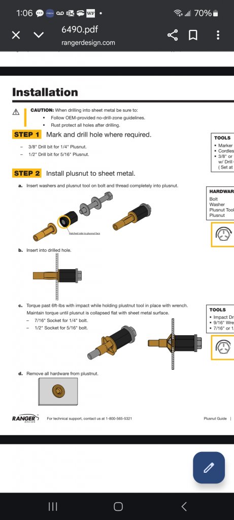

Find where you want to put them as long as it's double wall construction you could use rivnut plusnuts pull out strength is 1200lbs in a 1/4 plusnut .

@Ricko1966 - Plusnuts are definitely good for this! But its been over 20 years since I've had the headliner out so not sure what's up there to mount Plusnuts into. Figured I'd need to add some metal first so was hoping someone has pics
