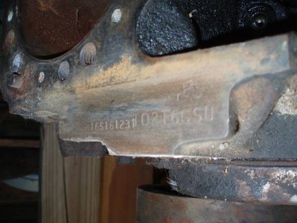

Anybody heard of a "GSU" 400 block? I know where one is.
$300 bucks!
GSU 1974 400CI 175HP 2 Bolt Main NB2
NB2 = CA vehicles with A.I.R. and longer valve overlap camshaft. In '74?
Motor code GSU: 1974 out of a truck, 2 bolt main with heads.
Engine casting is a 817, heads are 333882. ?
