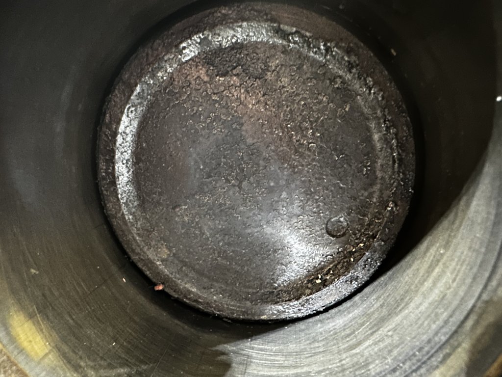

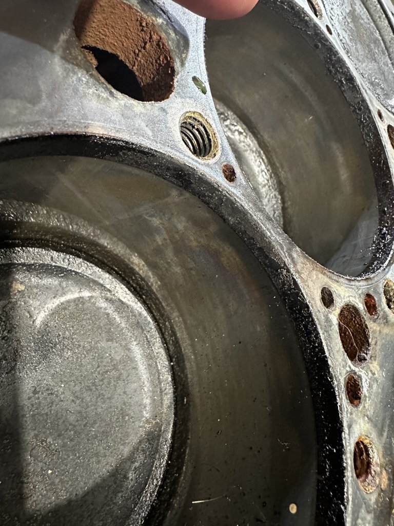

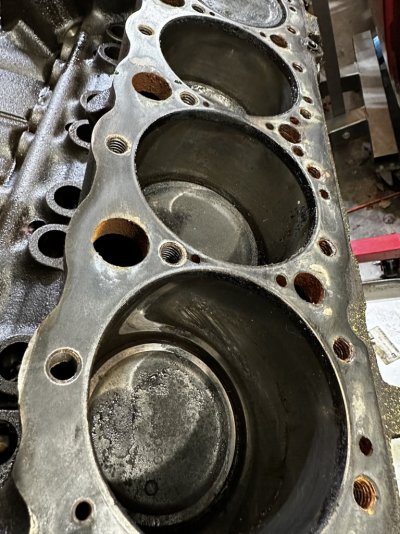

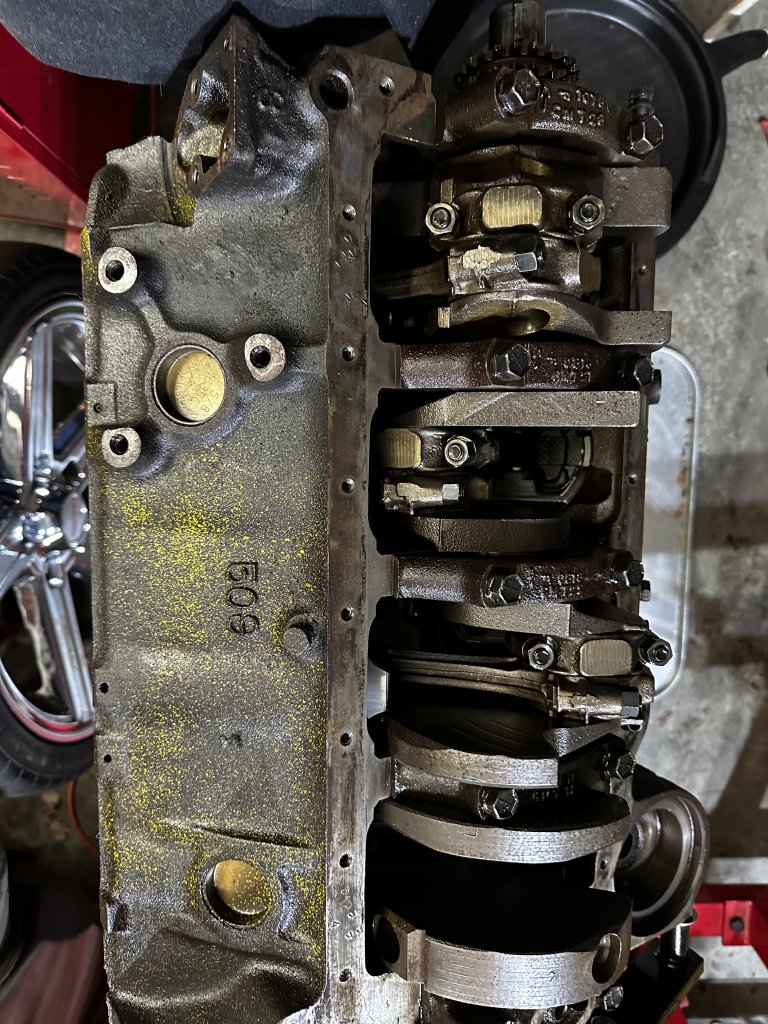

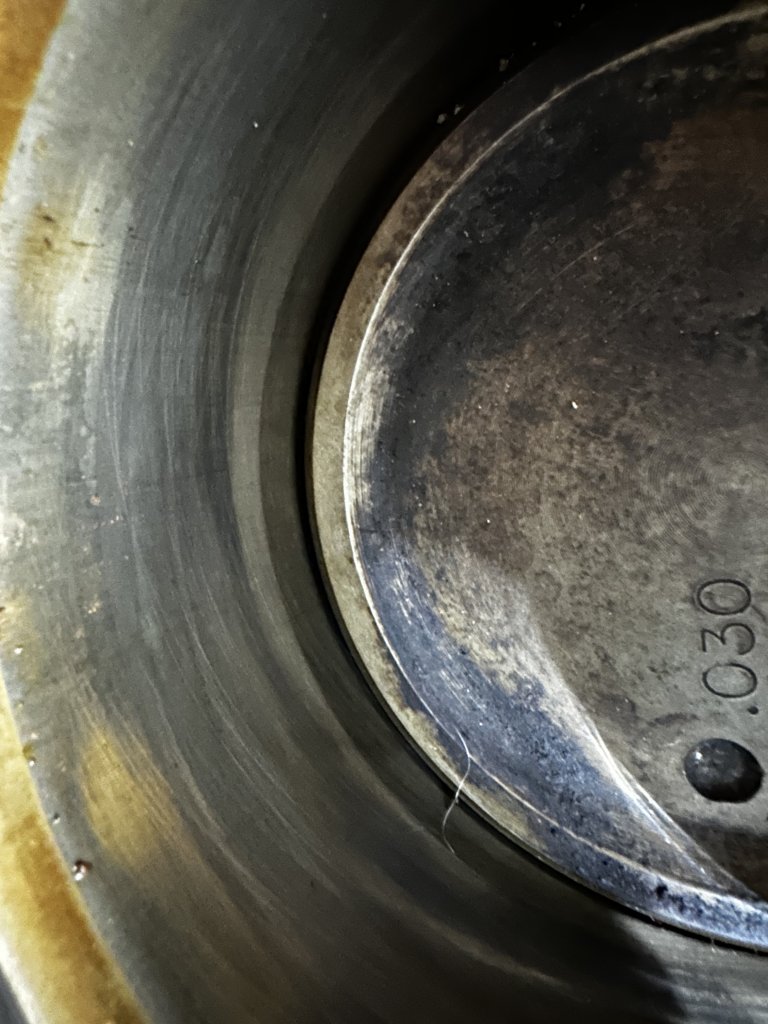

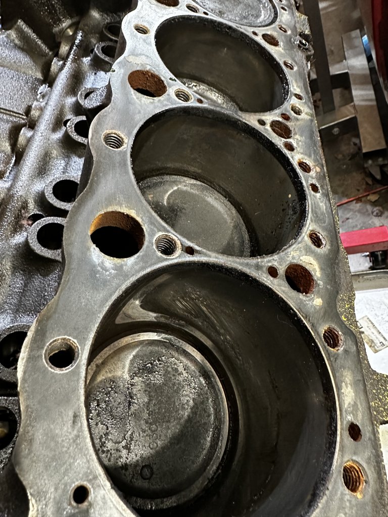

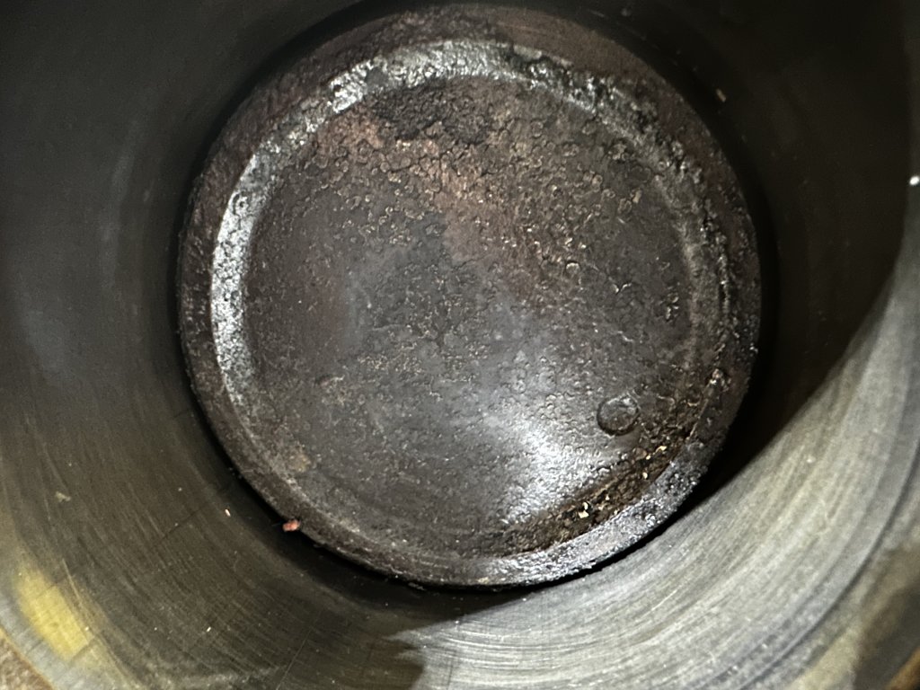

Engine is mostly torn down, left crank, pistons and cam in. Not sure how much of this stuff the shop might want to see? I’ve attached a few pics, not sure if it helps. Cylinders are smooth with maybe a light swirl or crosshatch. Top of each cylinder has an easily removed carbon build up, but no lip or overhang.

At this point I'm torn,because I can do this my self,butI think at this stage you should probably take it to the machine shop as is. Let them determine how much to deck it have them check the cc's in the piston, I want to know the cc's in the pistons and where the pistons are going to park so we can figure what cc the heads need to be to live on pump gas.

Sounds like a solid next step, I’ll drop this thing on a pallet as-is and run it to the machine shop this Friday. I’ll report back any useful information.
Thanks for the help guys, I really appreciate it!

First step here is to mag the steam holes for cracks, you have rebuilder special here, so it needs decked and honed to .040 with TQ plate. Line hone next.

Local shop is backed up a bit, so my engine is scheduled for hot tank and mag late next month. Good news is it only costs $50, so I'll know if she's worth building without having to drop to much cash on it. I was quoted $1600 for a small block rebuild which includes machine work, new crank, rods and pistons...though performance parts will be a bit...extra. I'll keep ya'll updated! Thanks again!

Might want to ask them to sonic check the bores while they are looking it over.
What is a sonic check on an engine?
Sonic checking is a method for measuring material thickness when you only have access to one side of the part. For instance, if you want to know how thick a cylinder wall in an engine will be, you would have to cut a hole in the wall in order to use a pair of calipers.
