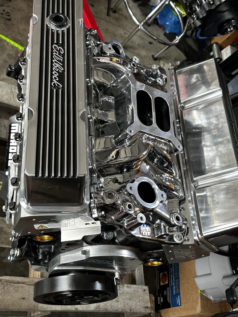

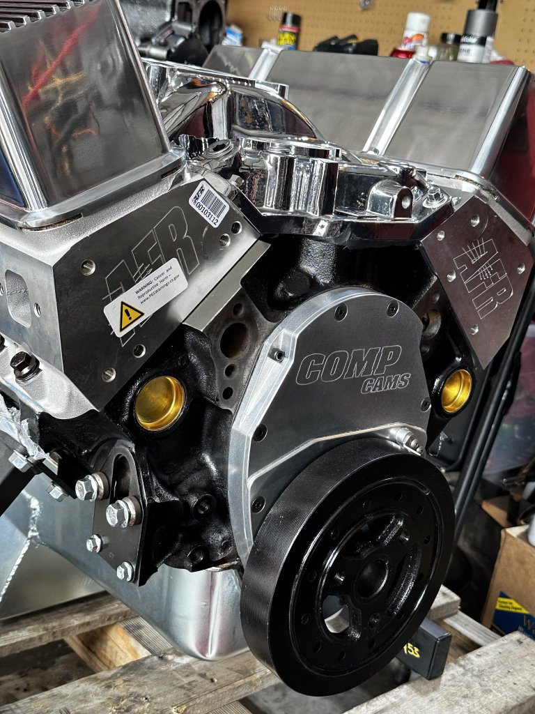

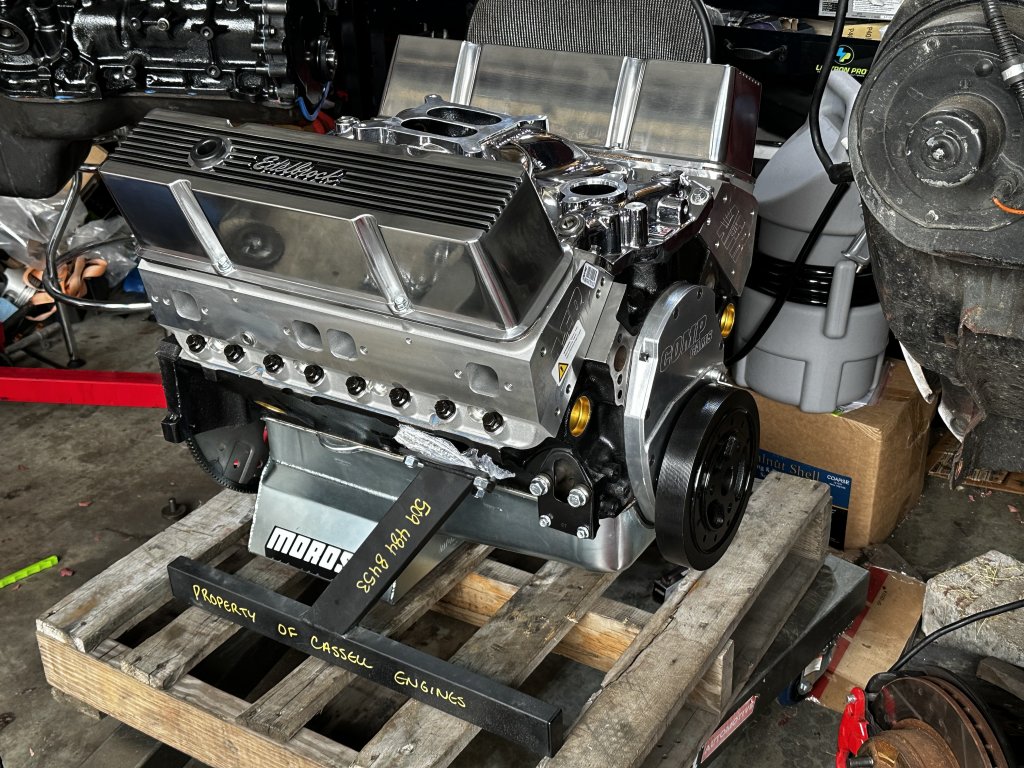

Well, it’s taken a minute…but the engine checked out, we did have to take it to .040 over. Blew up my budget as it came out to a little over 7k. Now just trying to figure out what kind of power I can expect from it.
AFR 1001 Enforcer heads (195/64)
Keith Black pistons -18cc
Full roller setup (cam, lifters, rockers)
Sure turned out pretty!

Did the extra cost come from all the extra metal they had to put into those skyscraper valve covers?
I don't think that I have ever seen a set of them so tall....
Looks good and should be a bitchin' engine for you.
