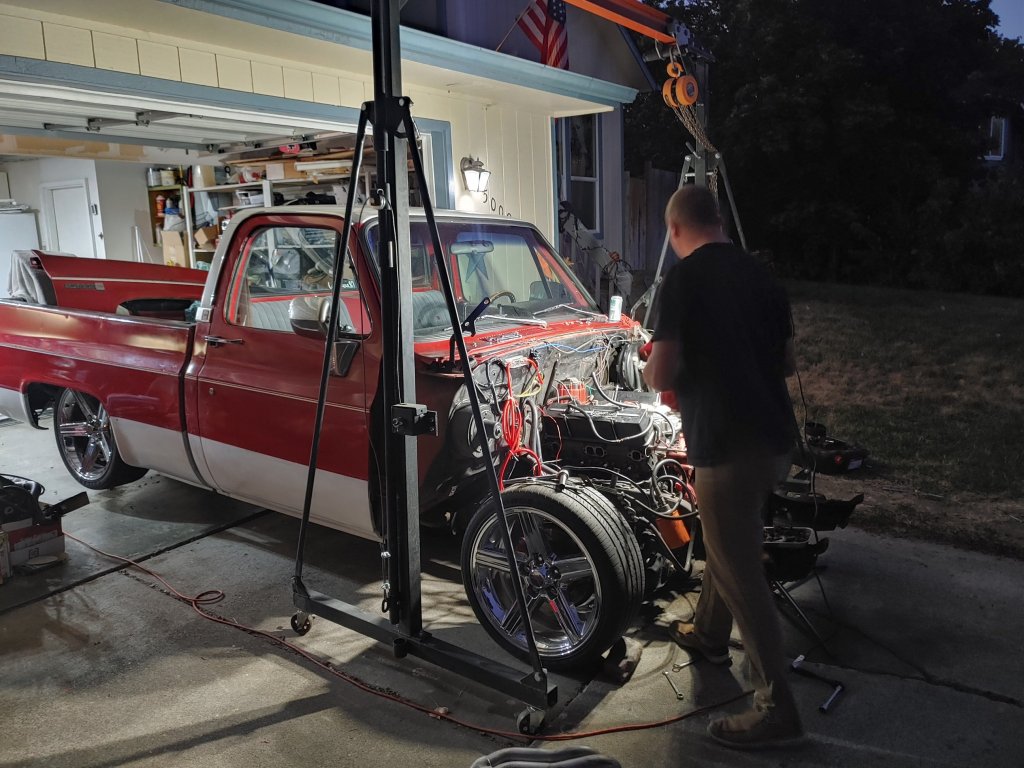

What fortuitous timing! I just pulled my 400 SBC w/TH400 last night! I will be following this thread closely, I'm shooting for 450-500 hp.
