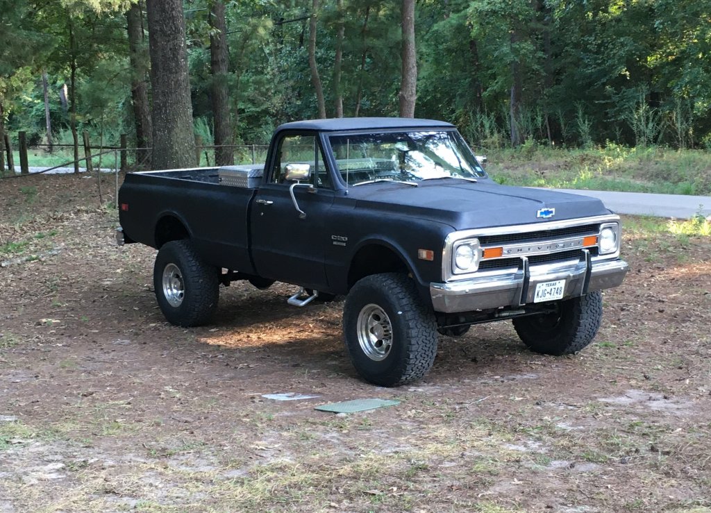

Thanks. Here it is so far. The P.O. did some sketchy looking bodywork but underneath its very solid. Hopefully won’t have to do much else besides interior once I get the motor and transmission back in.
Great looking truck, reminds me of my old Burby. Thanks for sharing and good luck with her.
