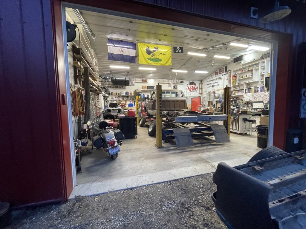

You’re definitely right about making your life easier. I installed my 2-post lift in 2016 and it’s the best tool I ever bought.
Mine is sized for lifting our diesel dually trucks, a Ram 3500 and Ford F-350. It’s also extra high as I’m 6’4”.
One thing to make you aware of is it can be a tight squeeze getting in and out of a vehicle. I’m thin and it’s tight for me. One solution is to pull up close, put car in neutral, get out and push it into position. Some 2-post lifts have the posts angled for more room but I don’t know how much more.
I’d love to find an old leather football helmet as I cannot count how many times I’ve cracked my noggin working under a truck!
