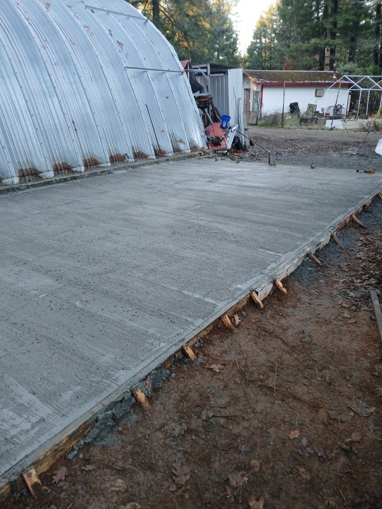

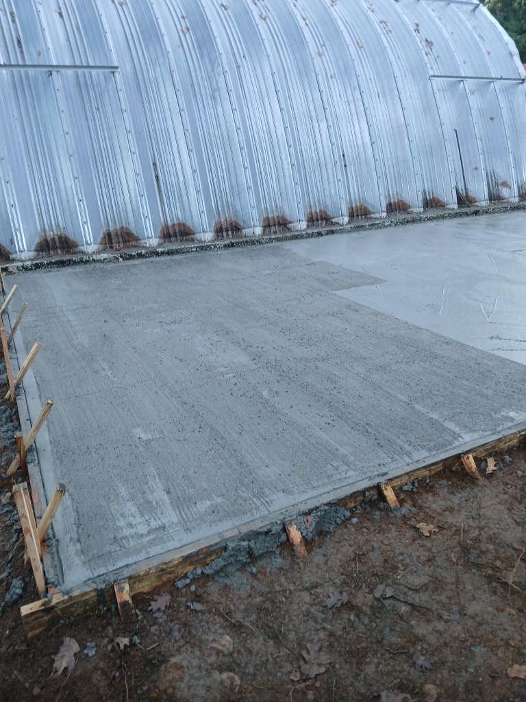

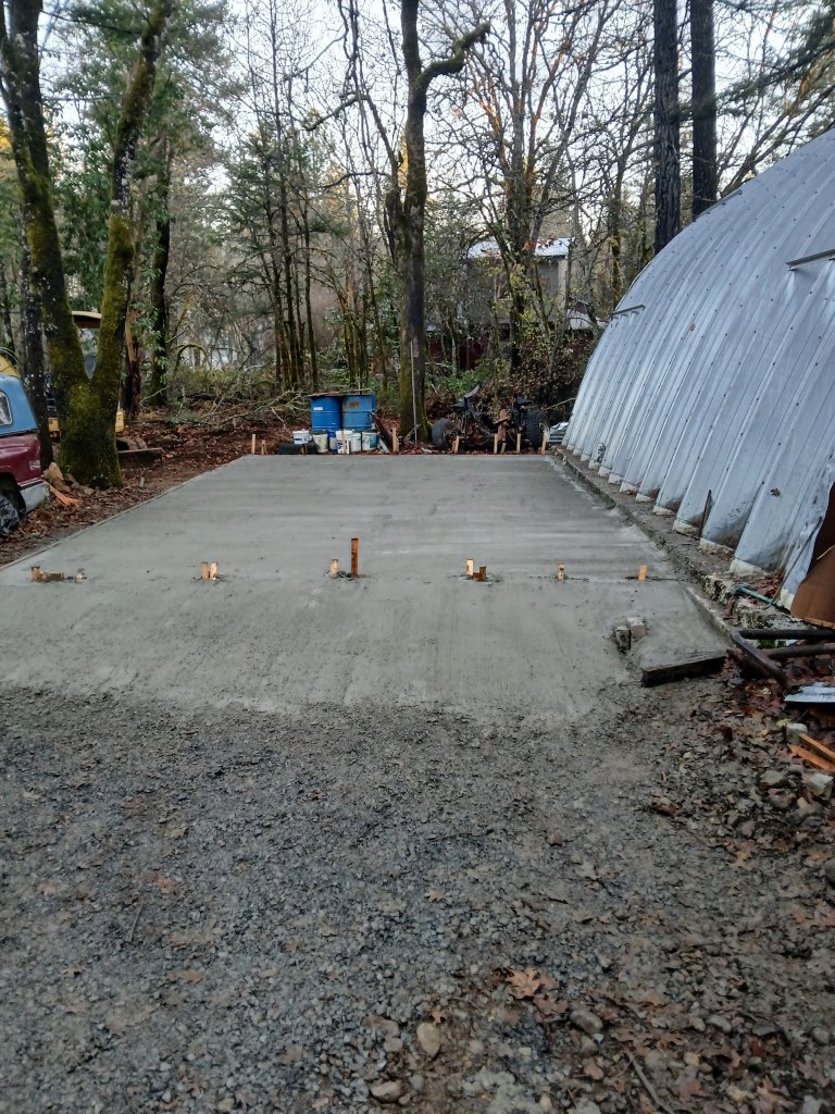

Getting closer! I ordered a little extra but Didn't expect to have enough to make a nice ramp into it. Brush finish so I might not slip so easily lol

I'm surprised you went with a broom finish. Is this going to be an exterior floor?

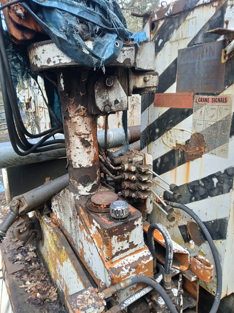

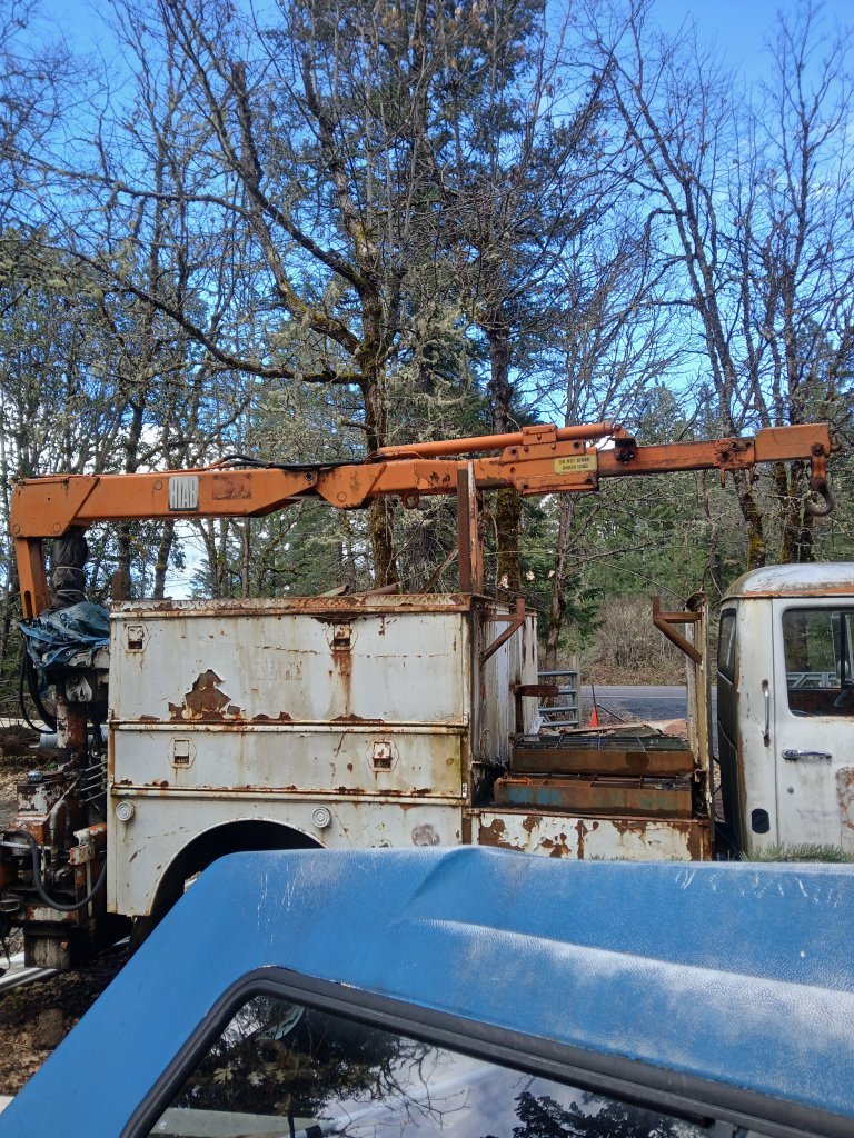

Have this crane and seriously considering sticking it in the corner to use for pulling engines and other things. If it didn't bend near the middle it wouldn't work for me but measurement wise it will fit good in the corner and be at a useful reach. I could always shorten it too. It does all work however the rotation motor needs rebuilt or replaced. It struggles and leaks allot. Maybe it only needs resealed. Either way what do you all think of the idea?

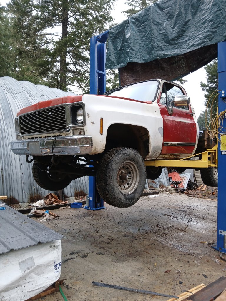

A friend who sells 2 post lifts, used an new, once told me the two most important things with a two post, other than weight capacity and equipment condition, is a cross member at the top of the towers and anchoring them in sufficient concrete with deep enough anchors.
