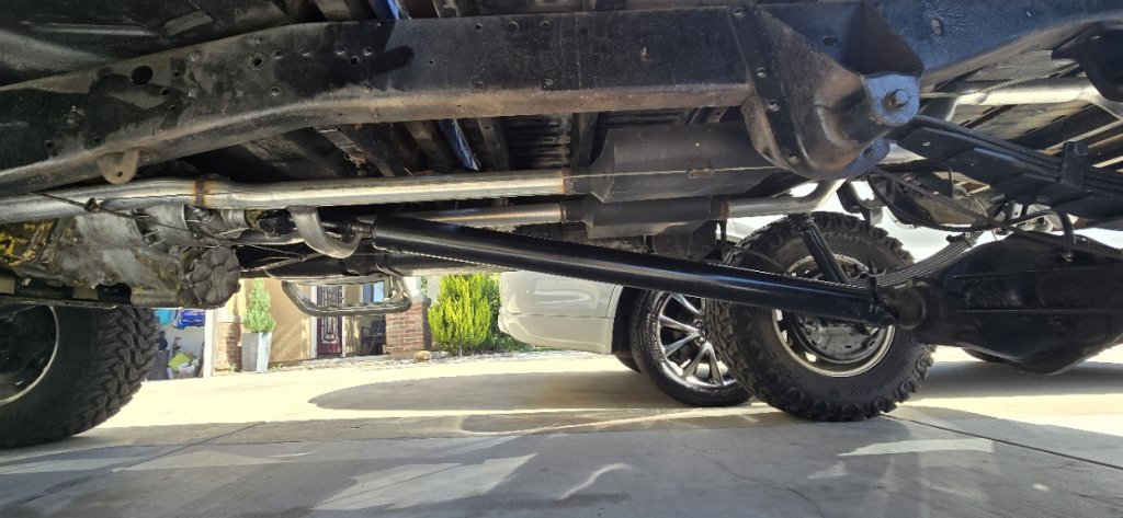

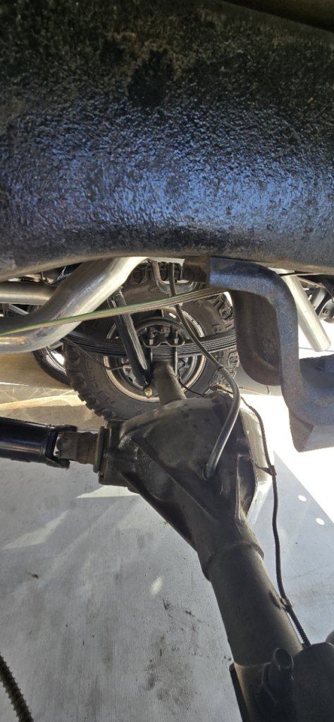

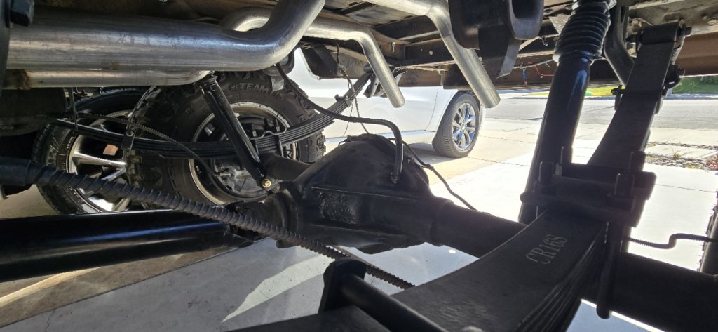

Looking for those with similar trucks that have 6" suspension lifts and driveline vibrations. I'm already aware of pinion angles and how they should be pointed based on the type of driveshaft. I've been fighting this vibration for awhile now and getting tired of installing and removing/changing pinion shims. I've already installed 1" spacers to lower my transfer case and reduce the angle and my pinion and t-case are currently at the same angle. The driveshaft is a new single cardan shaft with new 1350 spicer u joints. NP203 transfer case. Rhythmic pulsing vibration at 55mph is still there no matter what I do. I've read SOOO many other threads from guys that have had different solutions to this similar problem (balance the shaft, balance the tires, change the angles, replace the pinion bearings, replace the yoke bearings...) :emotions122:
Before I continue chasing ghosts and throwing money I don't have at problems that don't exist, I want to first see if anyone else here has a double cardan rear driveshaft on their lifted long bed truck and if that was the fix. I'm sure there are plenty of 6" lifted squarebodies out there without vibration issues with single cardan shafts- I just want to see if a double cardan is the next most viable option for me at this point. Although I'm not 100% certain it's the guaranteed fix, I'd rather spend $650 on a new CV shaft and be (most likely?) done with it, than spend countless hours and probably more money fixing/replacing (and probably breaking) other things in the process.
*Full disclosure* If you can't already tell, I'm currently suffering from "analysis paralysis" so go easy on me.
Any suggestions are appreciated!
Pics attached for reference.

Have you ensured that it is the driveshaft? Have you pulled the rear shaft and driven 55 on the front only? If the vibration goes away, that would confirm that it is the shaft and not the wheels, or something else? That looks like a bunch of up angle on the rearend; Are you sure that and the TC output shaft are parallel?
Maybe look in here: https://4xshaft.com/blogs/general-tech-info-articles/diagnosing-drive-shaft-vibrations

I appreciate the feedback. So I did try to drive on just the front driveshaft to test that theory but my transfer case kept slipping out of 4H - leaving me stuck in neutral. I have a part time kit in it and just couldnt get it to engage to complete that diagnostic. But once I put the rear shaft back on, I was able to engage it in 4H and 4L again. So- short story long-I couldnt determine for sure. The rear and TC are parallel. The original Skyjacker leafs I installed came with a degree shims installed under the leafpacks which had my pinion pointed even higher- directly at the TC. I removed them and check my angles which are perfectly parallel. The truck is parked on an incline in that picture.
