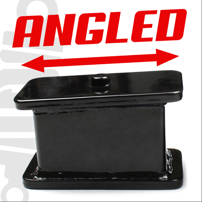

The angled / tapered blocks should have pins to keep them from moving.
it never occurred to me the blocks are angled. The current positioning of the angled blocks is pointing the pinion angle to far up and if i switched the blocks the other direction it should correct the pinion angle.
7,146
12,349
All blocks are not tapered,all blocks do have locating pins and holes. Tapered blocks come in different degrees to correct drive line angles but taper is limited,so you need to find out where you are when it's put together correctly. So we can figure our what you need to be where you need to be. I have a suspicion someone installed those blocks wrong to shift the axle position. See the peg and hole arrangement,I don't think someone missed the hole on both blocks accidentally,I think they were trying to center the wheel or cheat the driveshaft length.
these block are tapered and i calculated they have about a 2.4deg taper
