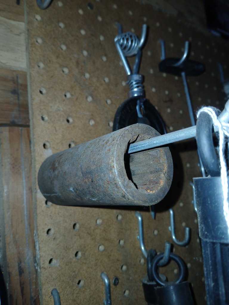

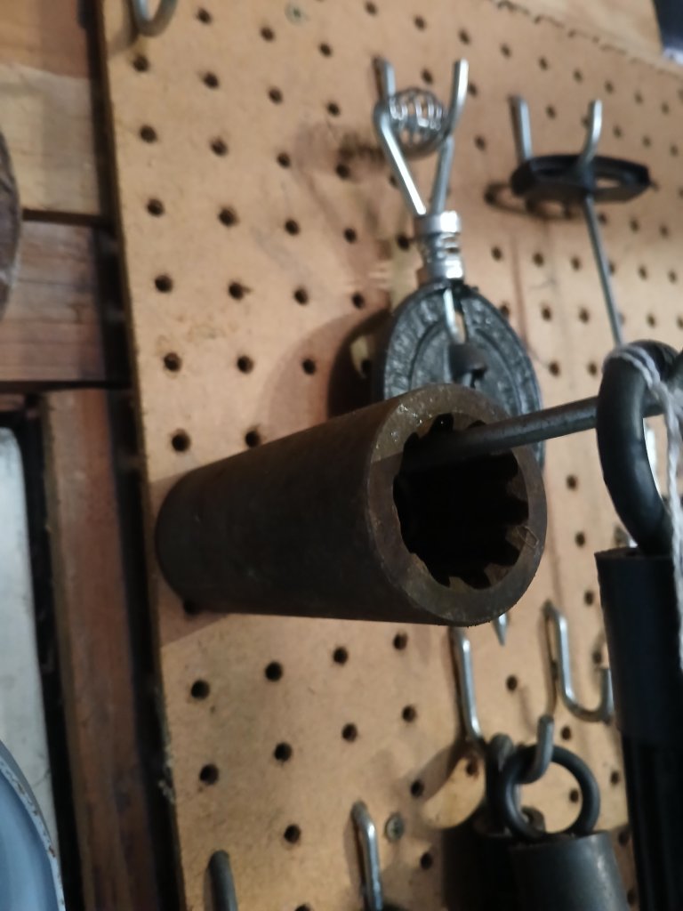

How about the splined sleeve that cupples the t case to transmission inside the pedestal? They can wear out and make noise. I broke one in 2 once.
My transfer case has a 32 spline female end on the t case that slips over the output on the tranny. No coupler
