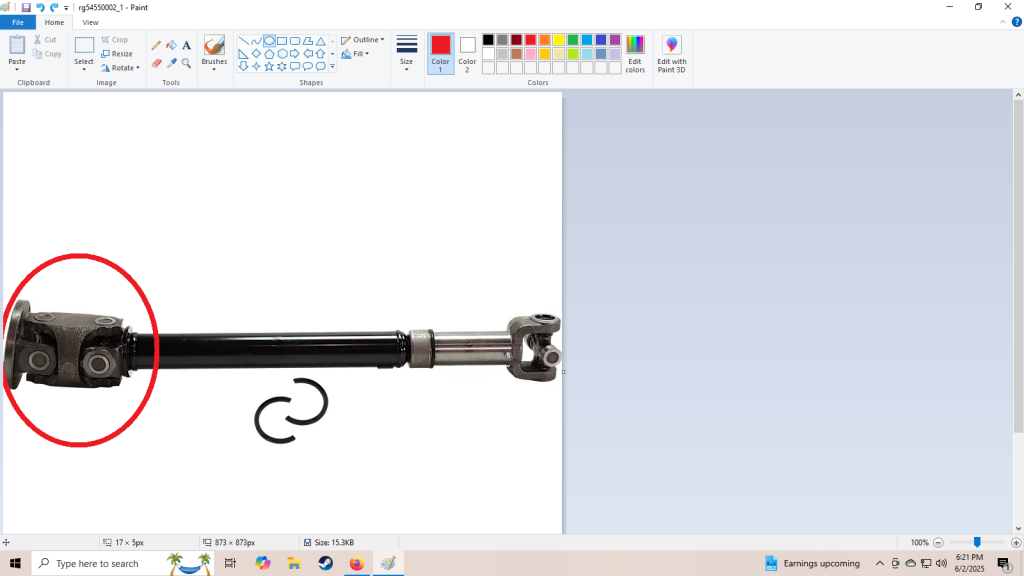

Does your front driveshaft have a CV joint on it?

I think you need something that is like in the pics shared. Should be cheap and easy to get. Standard equipment on a K5.
