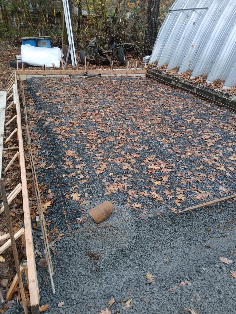

It's always kinda freaked me out too lol.

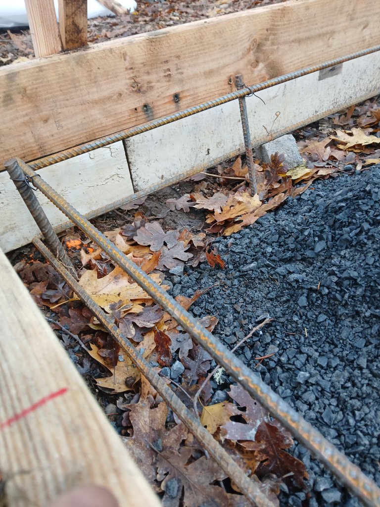

The bolts are 3/4" and concrete they recommend is 3000 psi and I'm ordering 3500 psi. Slab will average 4" but is a foot deep all around and under the lift feet. Just waiting for better weather now to poor it asap.
