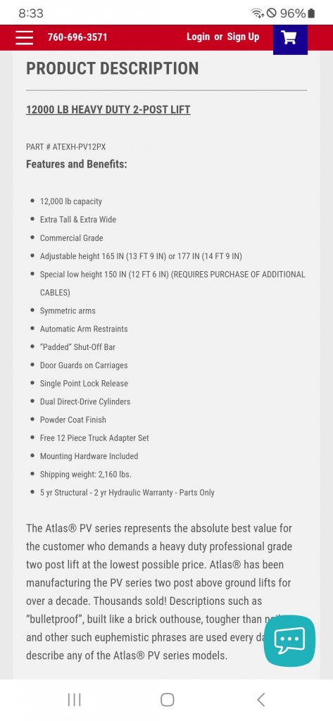

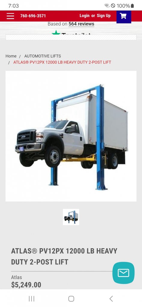

Thanks for the input, Its really helped me make a decision!
Pretty seriously probably getting this one.
Has Symmetrical arms. Going to poor a slab and put a tall metal carport with sides to put over it. I'll fill the end wall for shelves and work bench. Going to slope floor so I can pressure wash rigs in there. Maybe get a steam cleaner someday, Or make one.
found some good support stands and a trans jack to go with.

I believe that’s the one I bought in 2016. Use it all the time (Blazer is up on it now) and have never had any problems.

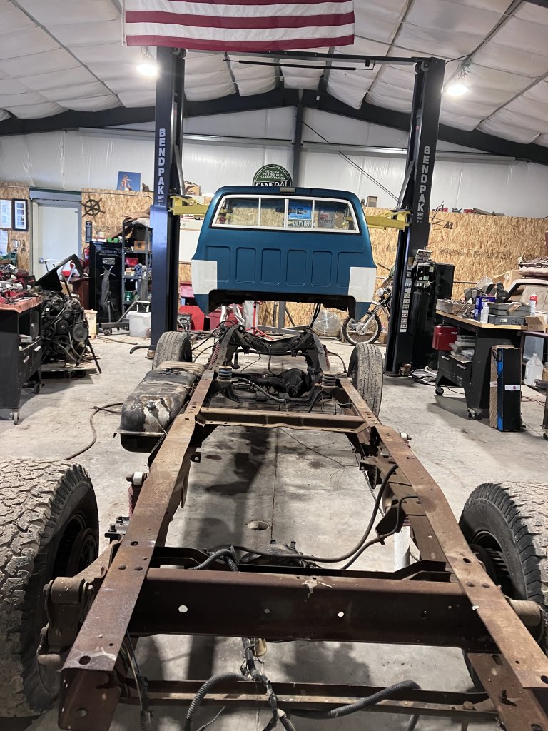

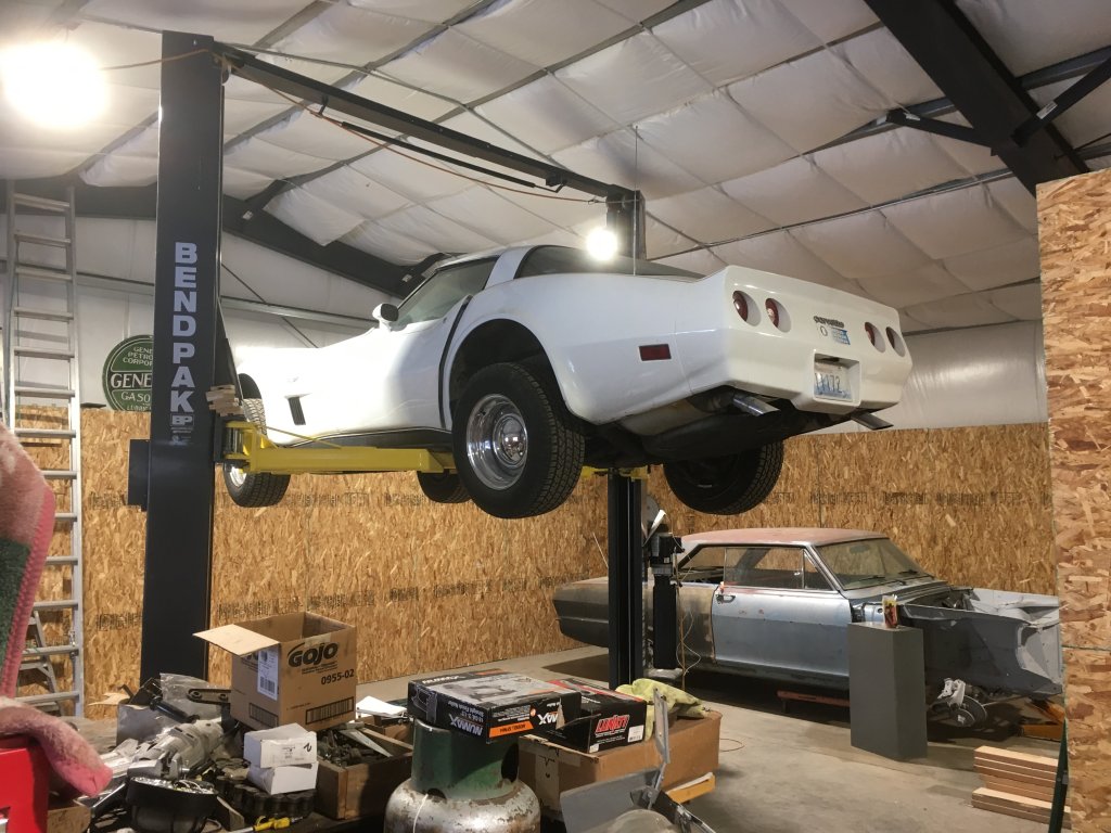

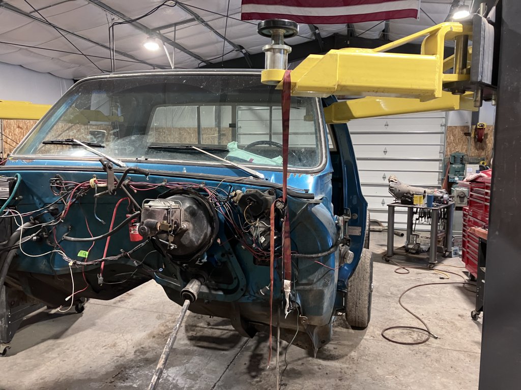

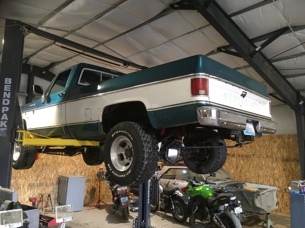

I bought a tall lift bendpak (70") for the same reason as RanchWelder. Mine is offset, and is is still a bit tight getting in and out, but no complaints from me. After I installed it has been maintence free. I like it because you can lift a cab off, put up the four wheeler or lawn mower. I can store a vehical up in the air. I use it for my K20 all the time. It is great for changing tires, brakes, front or rear end work, changing oil and etc. It is VERY IMPORTANT to lift the vehical correctly, I use the booklet that shows all the lift points for everything made, and leave it right at the lift handle. I also bought a Ranger trans jack and a oil drain system at the same time. Highly recommended. My concrete is 5.5 inch thick, and post is held in with four bolts on each side. I used two plumb bobs to get the first piller straight, and installed the second the same way at the correct width. Here are a few pics:
