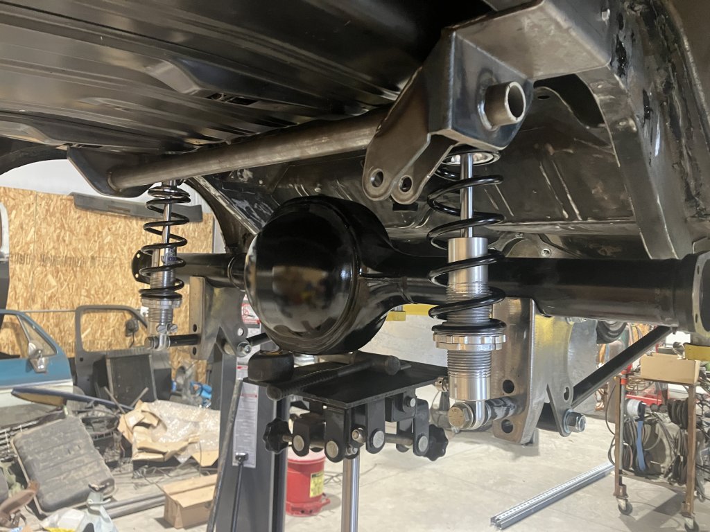

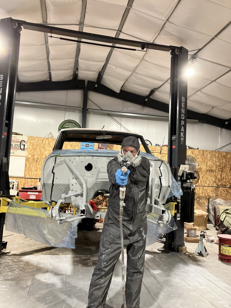

There is much to lifts, you will need about 6 inches where the posts are so there is enough depth for the bolts. my. Bendpak was not that much more then the offshore ones, I use it every week. Sometimes, like now with the Nova, it’s been on the life in the air for two weeks, while I have replaced the entire suspension, and clean paint, raptor line everything. If you pay attention where you place the lift arms, very steady. When I lift, I get the height I want, then lower it to the stops, and your good. You can paint under there, so restoring is much easier.

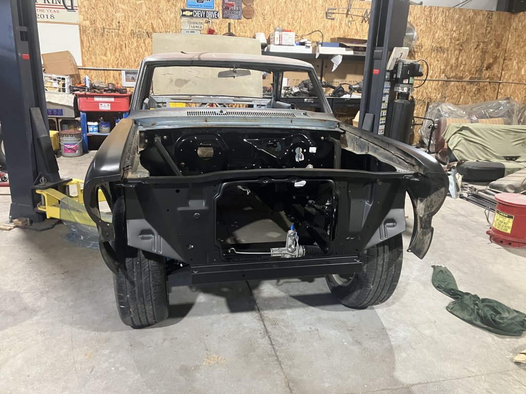

I set mine up myself. Two plumb bobs and shim till it is parallel when bolted. Measure and repeat on the other side. I bought the trans jack as well from bend pak, ranger brand, I use that under there all the time. This is the fourth shop I have built, and that single piece of equipment is now irreplaceable. I’m taking it with me when I move. BTW it is the high lift 10000 lb model 13’ height
