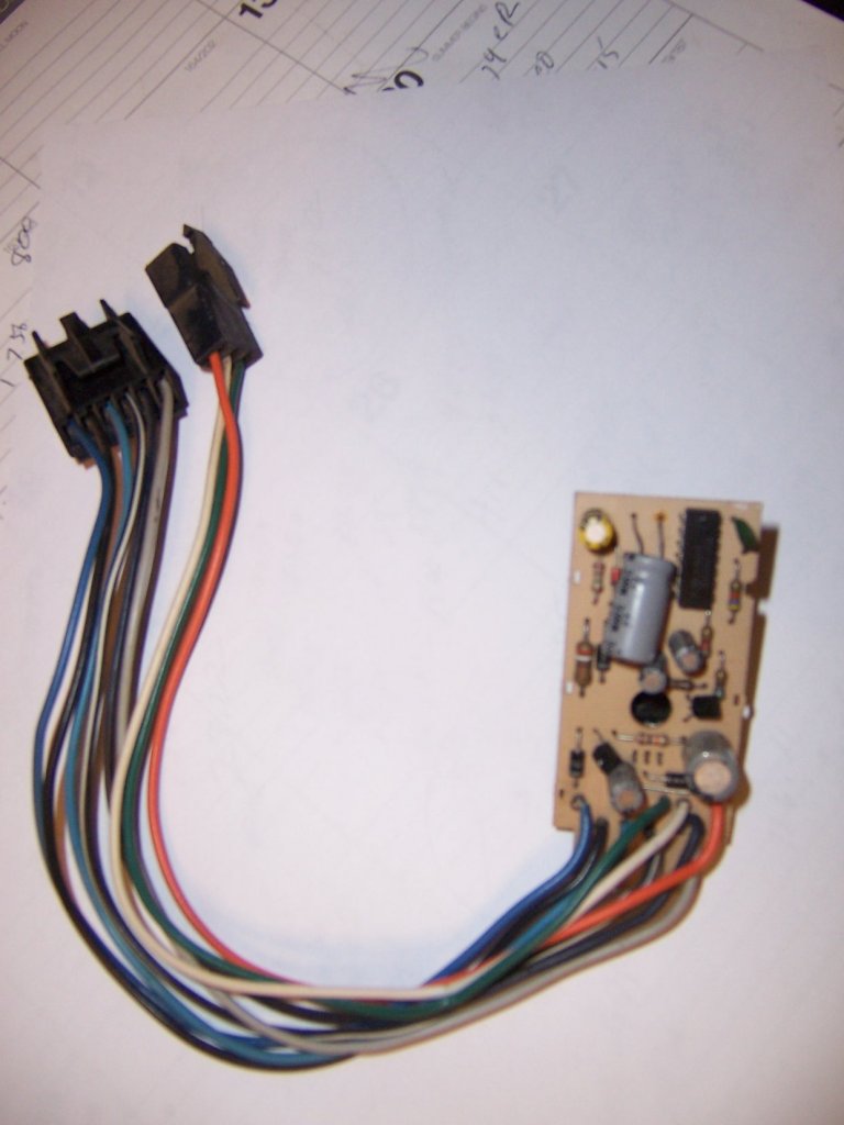

I don't want to resurrect a zombie post about this - but I wonder what the current thinking is about a replacement for the pulse control module under the steering column?
I had one with a bad solder joint that I re-flowed and it worked for a while. Now it too, is dead and smells really bad.
Currently I grabbed a toggle switch to make the wipers operate at all - and I get a little mental about having to time when to flip the switch OFF to get the wipers as low as possible because Park doesn't work unless you momentarily reverse the polarity.
I'm thinking of using a 13V/20Amp PWM generator to operate the wipers with infinite speed control ... am I getting warm?
