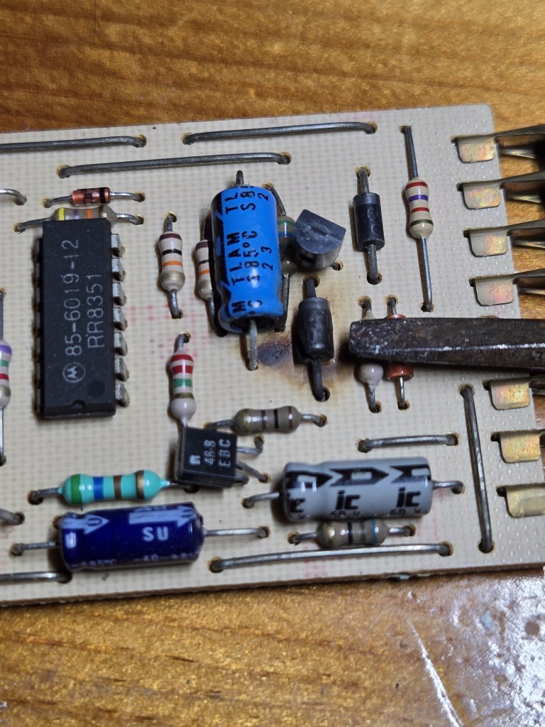

Here is picture of mine looks like d2 fried is this a resister? If so where do I purchase one I can solder it
cape square body
Jan 13, 2025
21
orleans cape cod
jpohn
v10
Found the fried piece is this a resister?

Looks like it is a diode.

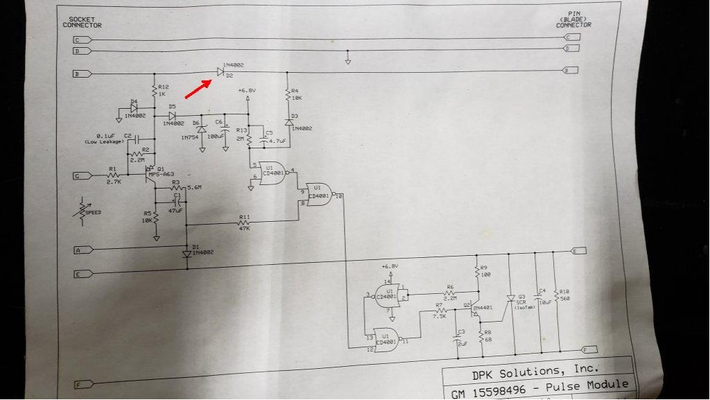

diode 1N4002
Just a Big FYI for everyone, the schematic calls that out as a 1N4002 (1amp 100v) but on all the boards I have worked on, and even in the picture its a bigger diode. I have found G4B/4 diodes (obsolete) and other part numbers on there, they are all the same rating, it should be a 3 amp diode, part number 1N5408. Working on a test setup to check these easier and fix them. I have had lots of requests to fix them. I will keep everyone posted.
