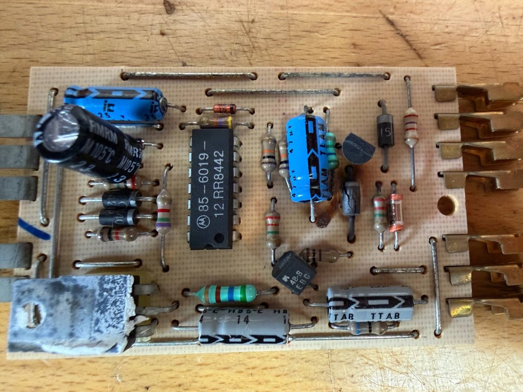

The SCR part number I am currently TESTING (will know more in about a week), is TYN616RG from mouser.
A SCR is a silicon controlled rectifier, think of it as a diode that is turned on with a switch (its gate), once turned on it acts like a diode and will conduct even if the power to the gate is taken away (so the switch is like a one shot turn on), to turn it off you must take away the power from the diode itself, that will reset it. I talk about it in my terrible video, man I need to make a follow up video LOL.

Mine had issues from the factory. I was wondering and has already probably been answered. Can you bypass the module, will the male and female connections on the input and output simply plug together?

Could it possibly be a MOSFET?
