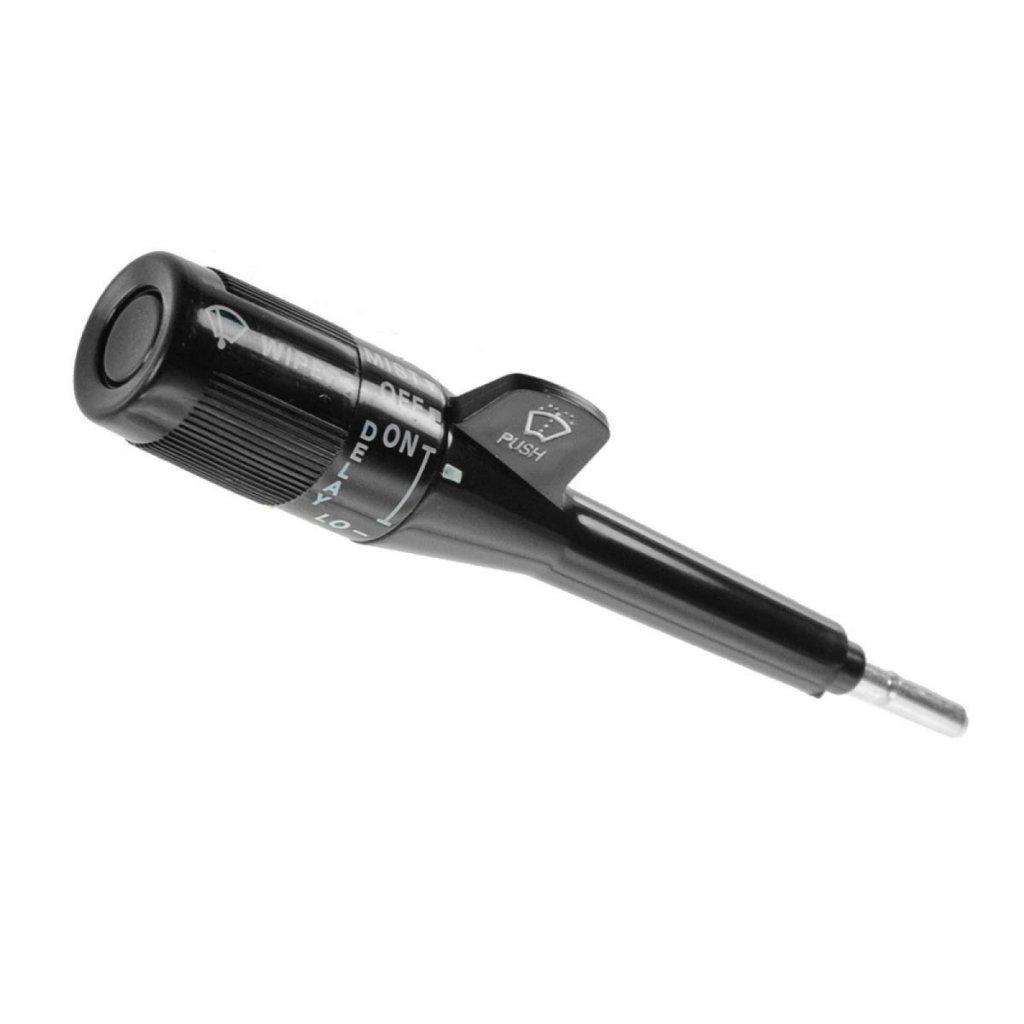

I do not know how to test the control arm. I have the style that is a single wiper control twist top, and up/down for the turn signals. My indicators do work as intended, just with some loose play of falling out of indicator “on” position. I attached photo to show style. As mentioned above, once in a blue moon if I flick the control on, they’ll quickly bump down an inch. If I try to turn on the killer power jet washer fluids, I am left in disappointment of nothing. Turn signals work as you’d hope.

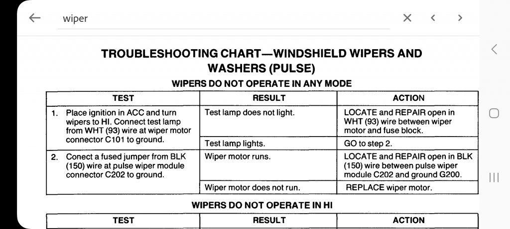

Thanks man for the suggestions! I have found the service manual for my gen of K10, and was finding diagnostic advice for everything but my certain issue. I tried to follow them and what I was finding was okay. I do know the fuses are testing okay.

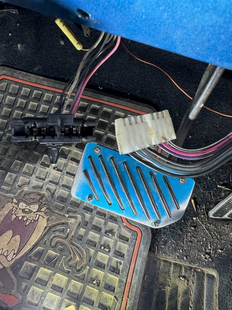

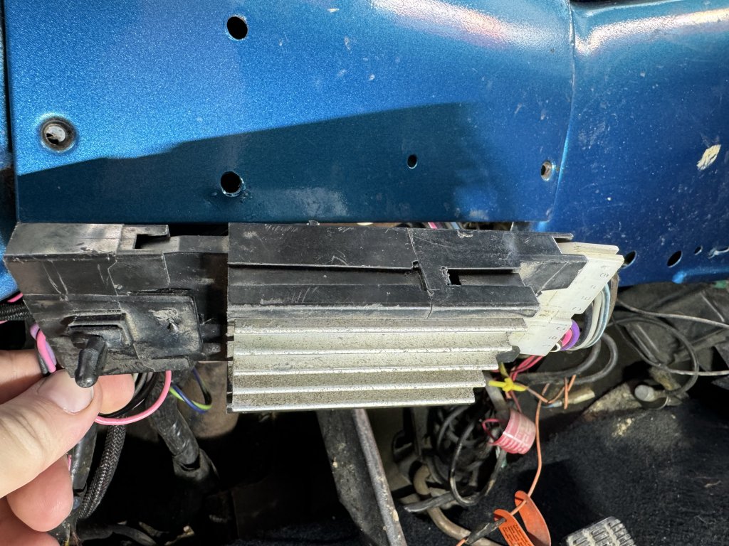

For the delay bypass, are the cables not supposed to line up? On the female I have _- -_ | _- -_. For the male I have all - - - - | - - - -. I attached pictures for better understanding. I forced them puppies together and I still didn’t have anything. Getting them back apart was a good time. lol I appreciate the help, ya’ll!

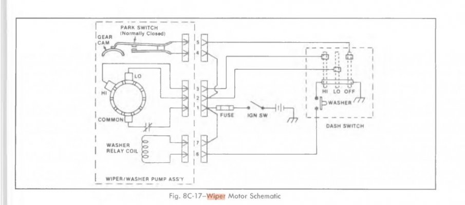

see if this helps

The best I can tell from your picture the wires appear to line up. Female _---|--_ & Male ----|---
The outside wires on the male (usually brn) deal with the delay and should have a blank spot on the female.
A white wire (wht-93) will run directly to the wiper motor & wiper washer pump- It comes from the fuse panel (wiper fuse) and supplies the current. The wiper switch on the column grounds the circuit. Pink wire is washer. Purple wire is fast wiper. Gray wire is slow wiper. Black light Blue wire is for parking the wiper. Black wire is ground. To test to see if your switch is bad you could briefly ground the individual wires one at a time (female connector) to see if they work. Same principle applies at the wiper motor- (example- briefly ground the terminal that the purple wire connects to at the motor)

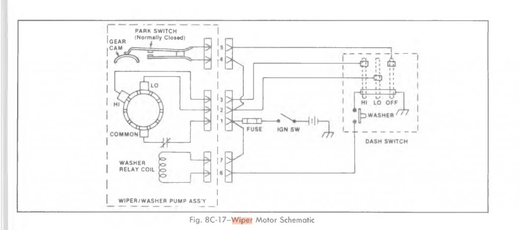

very basic schematic of wiper
