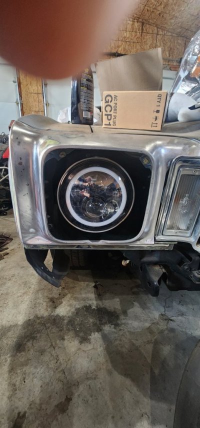

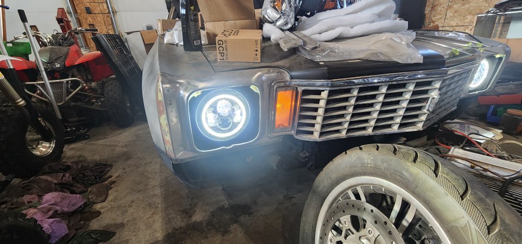

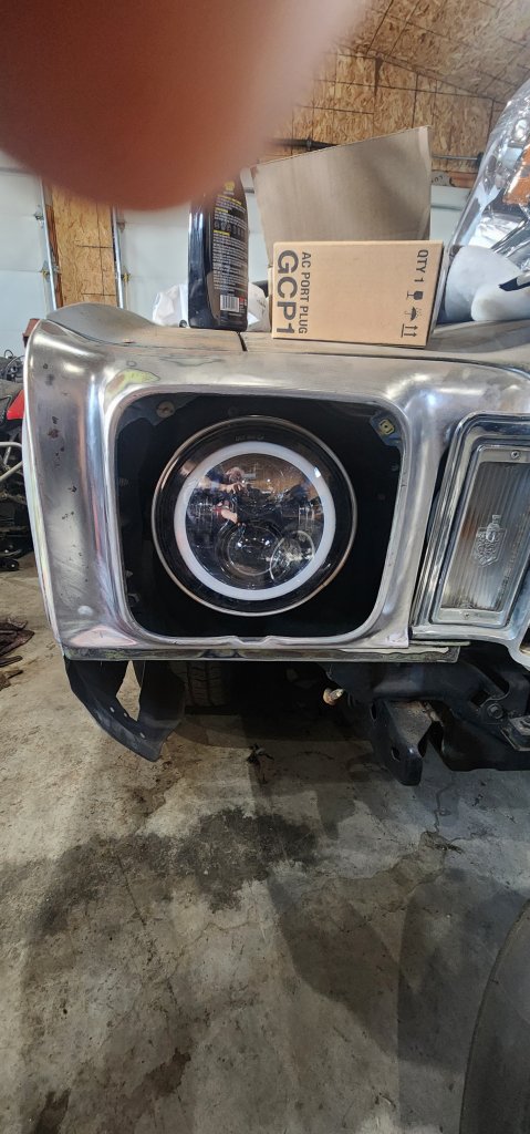

I just installed these nice and bright LED headlights on my 72 Monte Carlo. They look exactly like my Harley headlight, except for the halo ring.

Ok, now we are going to require that you post a thread for your Monte in the Other Vehicles section! I love the '70-'72 Monte Carlo! And the a$$ end of the '73 too :rofl:

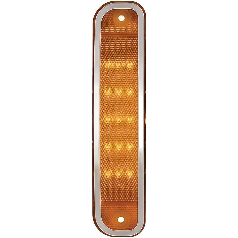

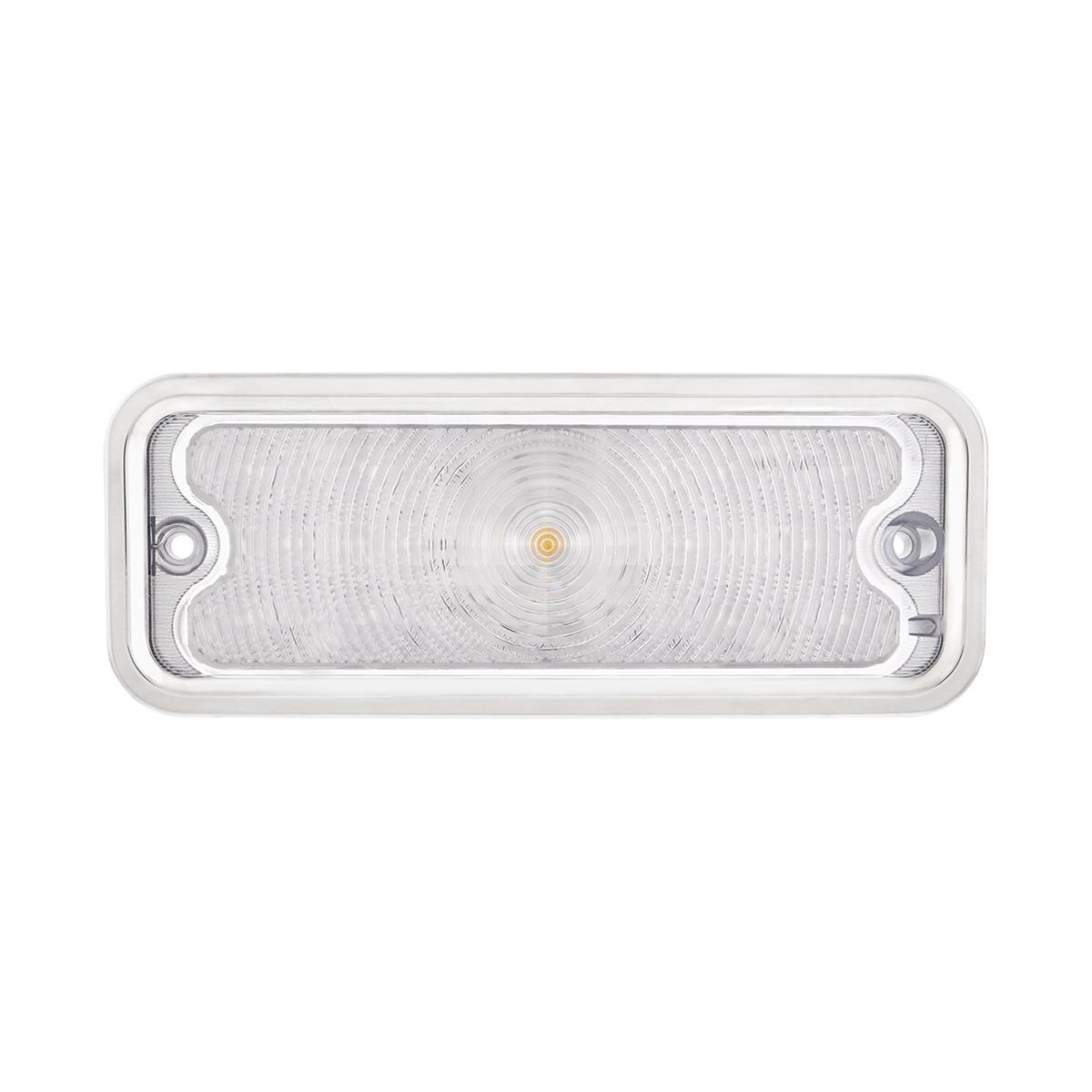

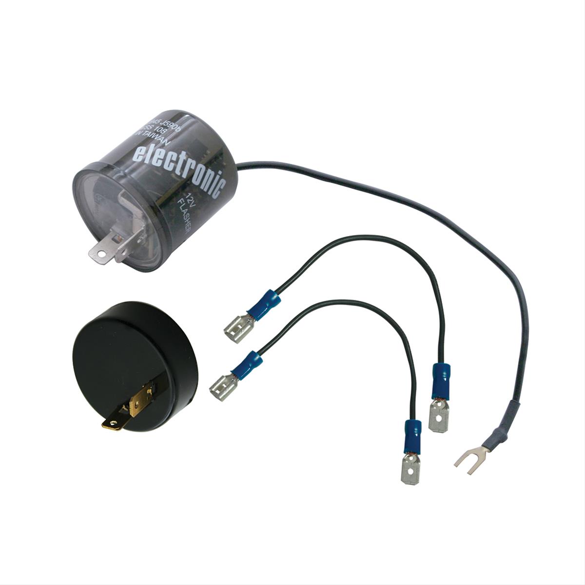

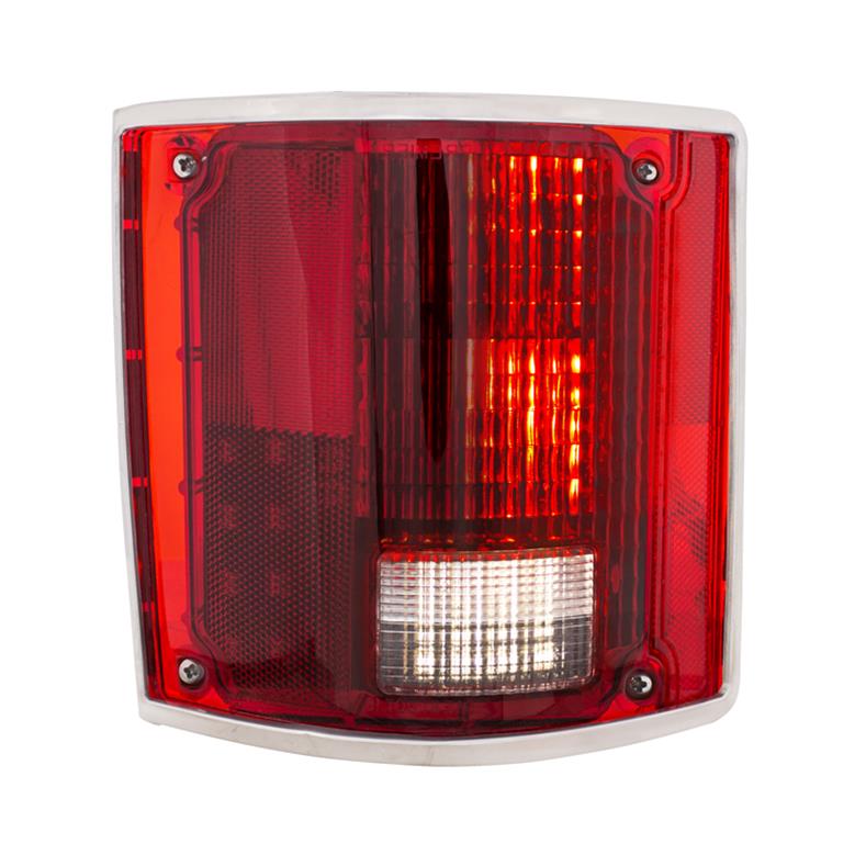

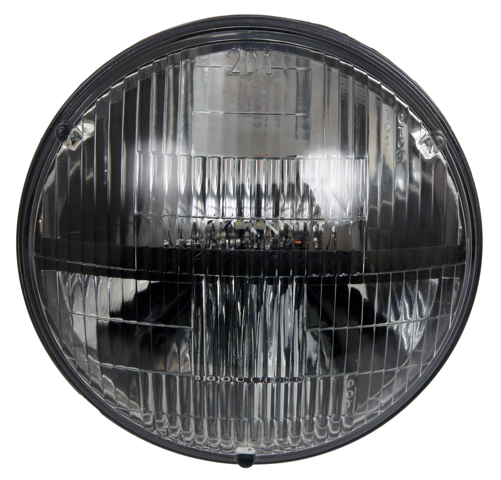

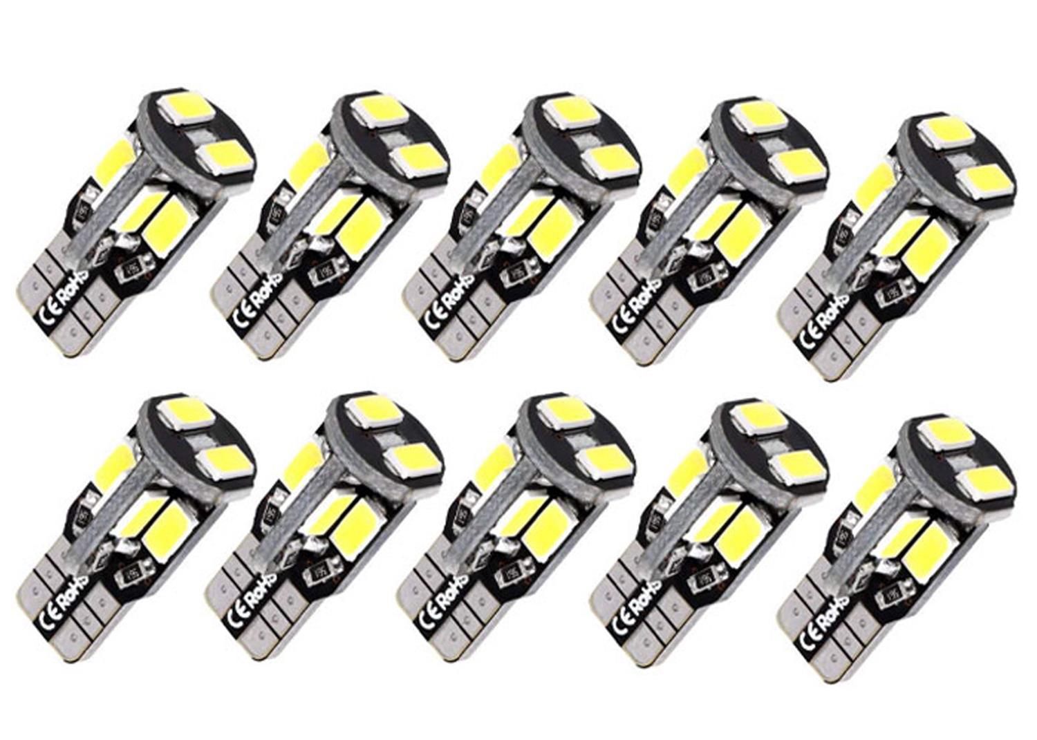

I went full LED nothing needs spliced or modified they all plug and play into the stock sockets.
Headlights
Front signals (they sell a yellow lense version as well)
Markers (they sell a red one for anyone that has the rear markers)
Tails (you can switch the sequential turn signal off, so they act like stock just on off, brake lights are not sequential)
Flasher X2
Guage bulbs (believe they fit stock cluster but I'm using them in Auto meter gauges)
Headlights
Flasher X2
Do you have the spec on (or are you equipped to test) the current draw of those LED headlights? They look pretty good and I like the glass lens as opposed to plastic, but Summit doesn't list the actual current draw on them.
Don't have any specs as far as what they draw and I couldn't test them as I think someone needed my multimeter more than I did as it seems to have walked off.
Headlights
Flasher X2
I second the Summit racing LEDs. I have them in a couple of vehicles now and really like them.
