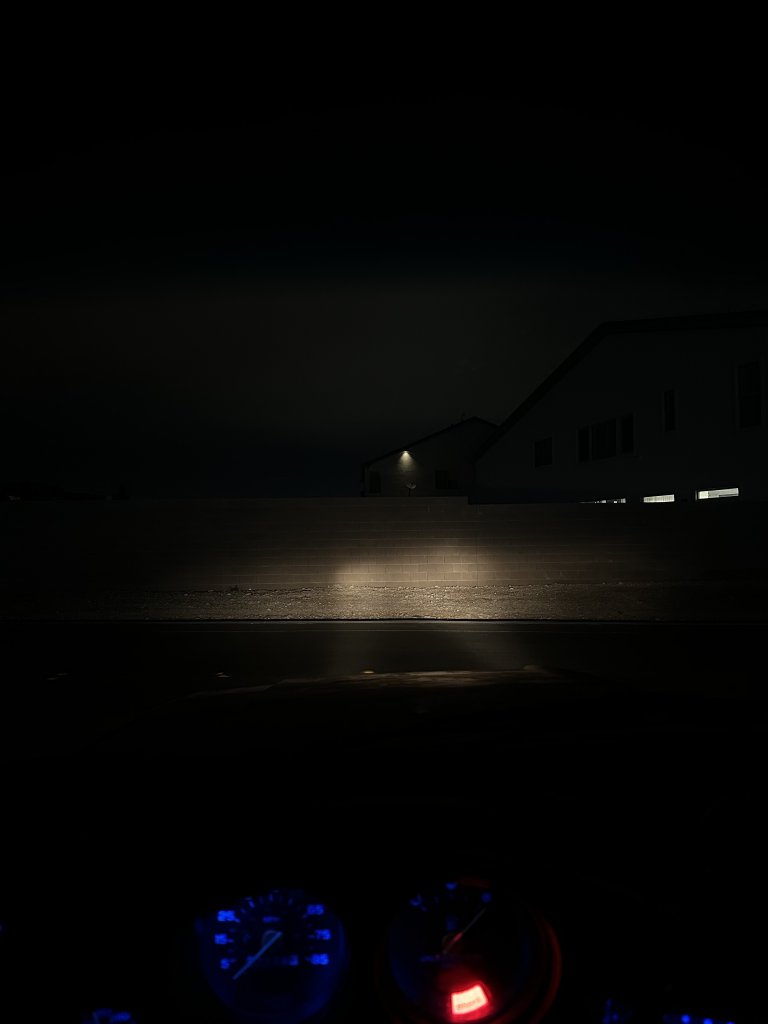

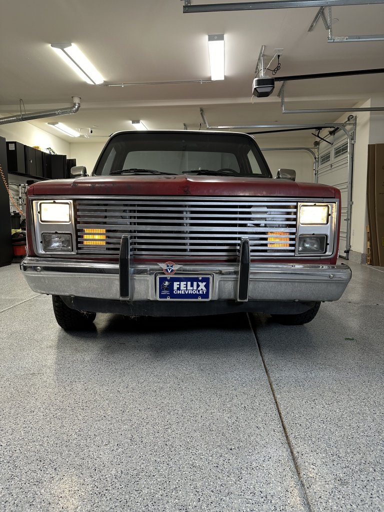

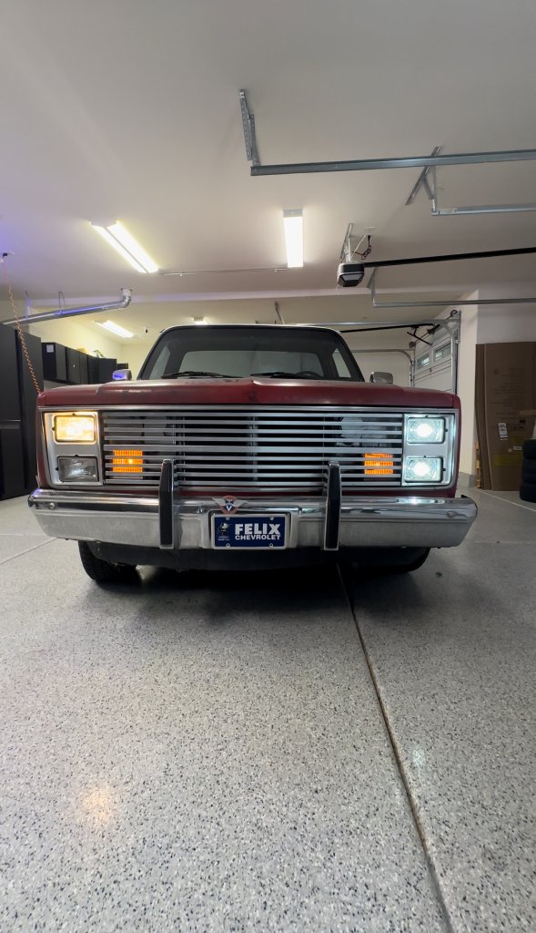

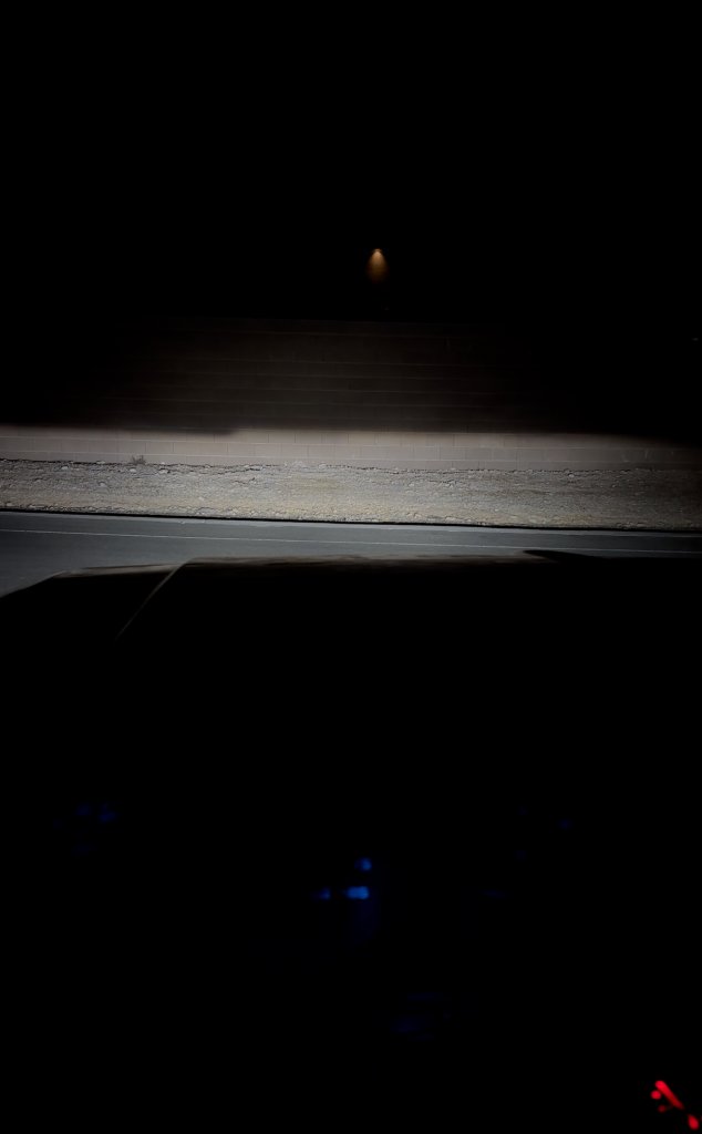

We just did a Dapper Lighting FourSix BiLED kit on our shop truck. They came out awesome.

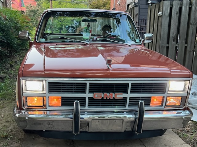

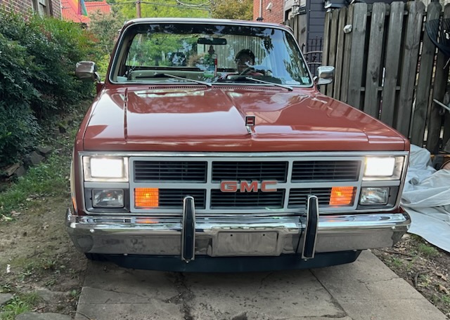

Very happy with these headlight housings:
And H4/9003 LED Headlight Bulb from Amazon. Bright and clear, and pull less current that stock or halogen bulbs.
I also had to buy a pair of these:
https://www.amazon.com/gp/product/B01N5HLF7U/
So I could reverse the wires for High beam and Low beam. If you plug them in straight out of the box the you'll get only low beam on high setting, and get all 4 high beam on low setting. You could also use this to have all four lights do both high and low beam. But I went with the tradition style with 2 lights for low and all 4 for high beams.
Top lights new LED, bottom original lights. BIG DIFFERENCE
Price for all the stuff from amazon was about $100 to $120.
