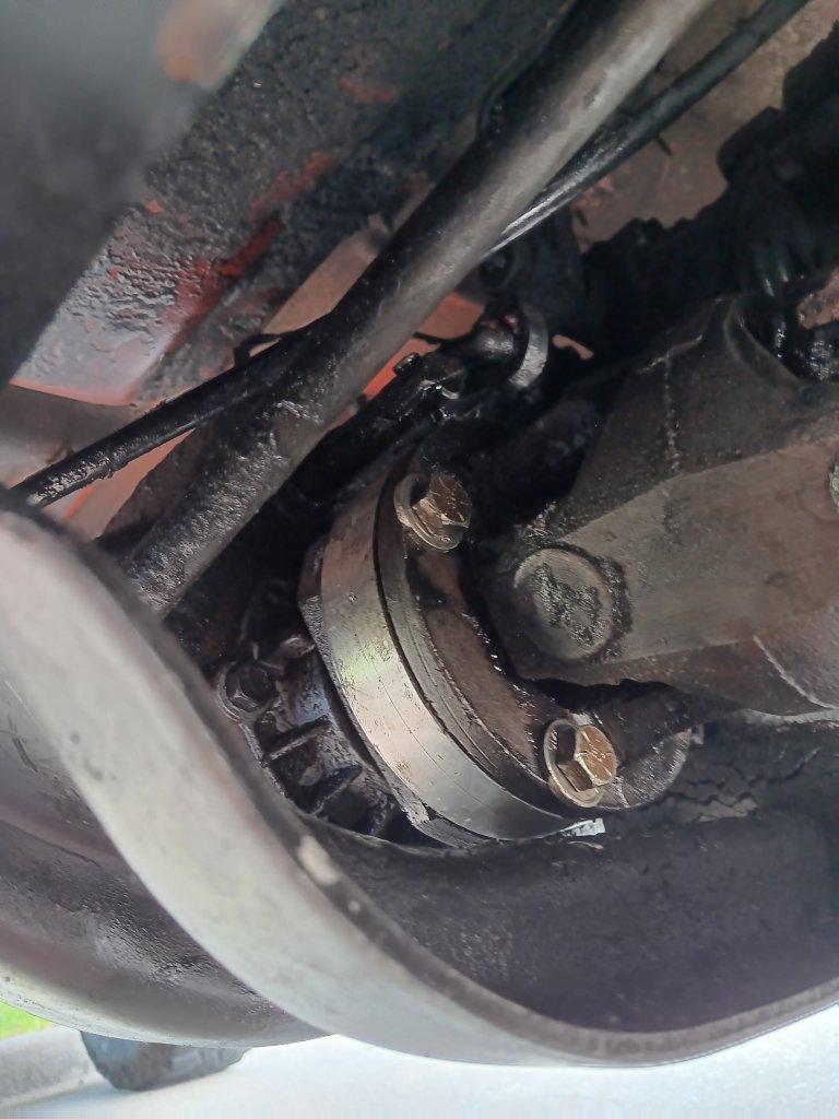

No pics, but compliments of a lift at work and a helping tech the spacer for the front driveshaft is on ! I tried last night in the driveway - could not get the spacer to go where it is supposed to between the driveshaft and the t-case flange. The lift at work provides suspension droop which I think made all the difference is getting space.
Bonus was to drain the transmission fluid out of the t-case ( leaking from the transmission ... :rolleyes: ) and put gear oil back in.
Shifts back out of 4WD on the pavement MUCH EASIER now.
EDIT- after the fact pics !
That slipshaft doesn't look like it has much travel? What size lift?
4 inch lift. I am kinda with you, but there was not enough engagement before and this spacer is only offered in this size.
It's aluminum so it could be machined easily if someone worked at a machine shop. Best option I have is a brake machine and that won't put the counterbore back in if enough gets machined off.
So, we are gonna find out how it does as is.:think:
I'd be hesitant to run that. If it were mine I'd rather have not enough engagement than not enough travel.
If you bottom out the driveshaft only place for it to go is to shove it into the tcase or diff.
Is it full time 4wd? If not then I wouldn't really worry about not enough engagement, and just take it easy in 4wd. Until you can get the driveshaft lengthened or the spacer machined down.
Not trying to fear monger or say you're stupid, I just don't want to see you blow out the tcase or diff!
I ran my stock length front shaft on my 4 inch lift for about 7 years 50,000 miles, splines just barely stuck out of the slip tube. Non full time 4wd. Finally had to rebuild the splines and had it lengthened I think 1.5 inches.
