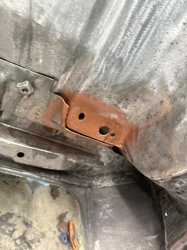

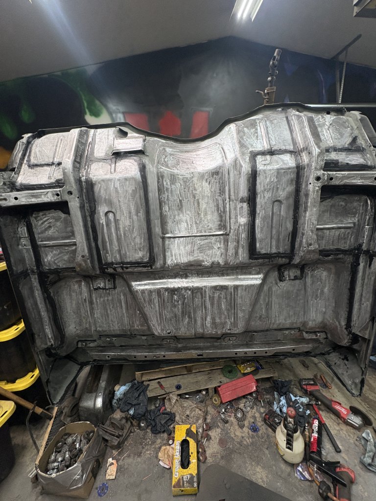

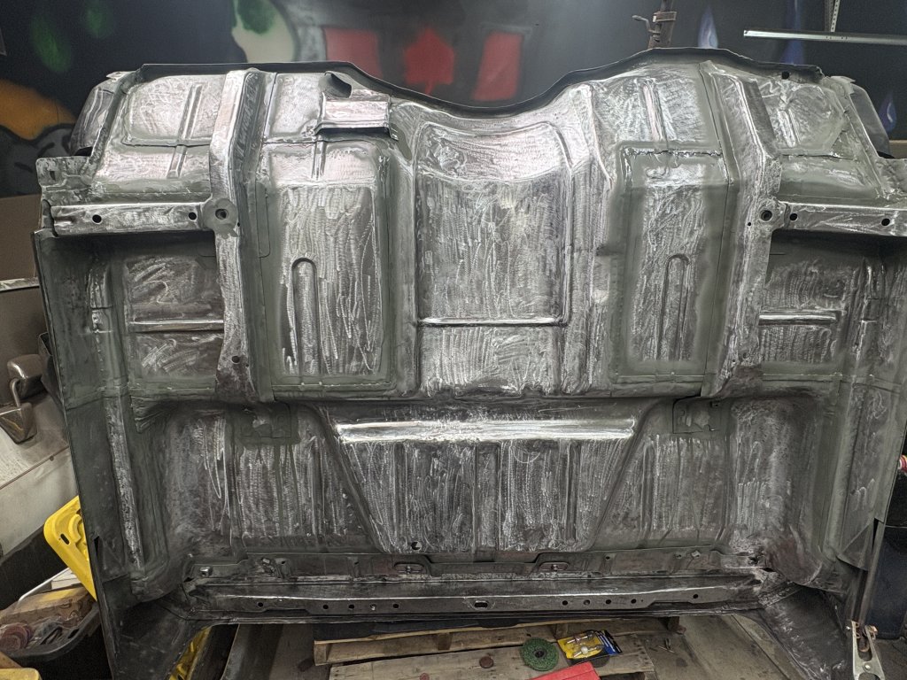

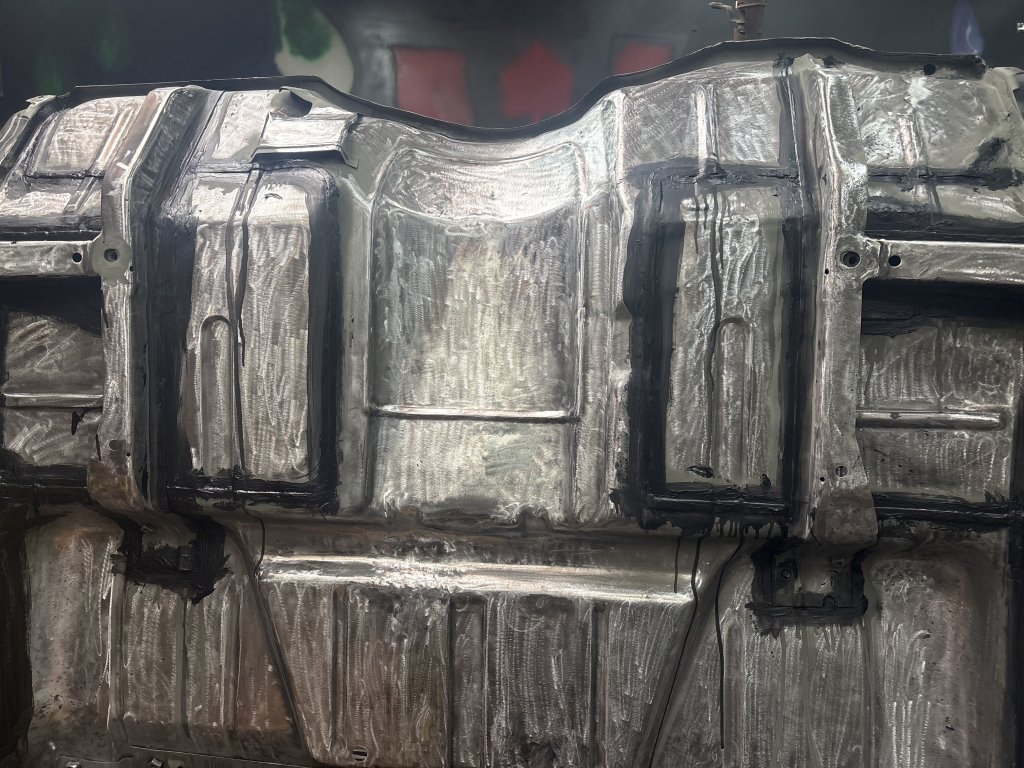

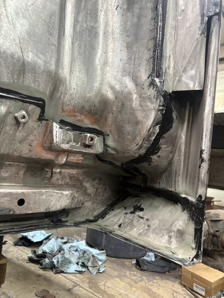

Been a few weekends preparing the bottom of the cab, filling pin holes with weld, knocking as many dings flats as possible and finally forcing self etching primer into the seams before sealer went on, polishing off Easter weekend with a free junkyard cut out seatbelt nut and getting it welded in.

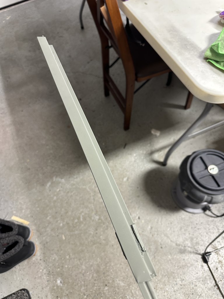

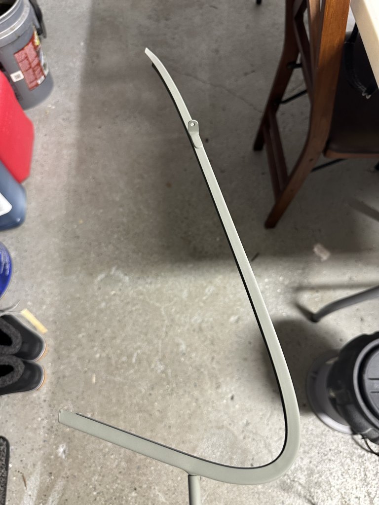

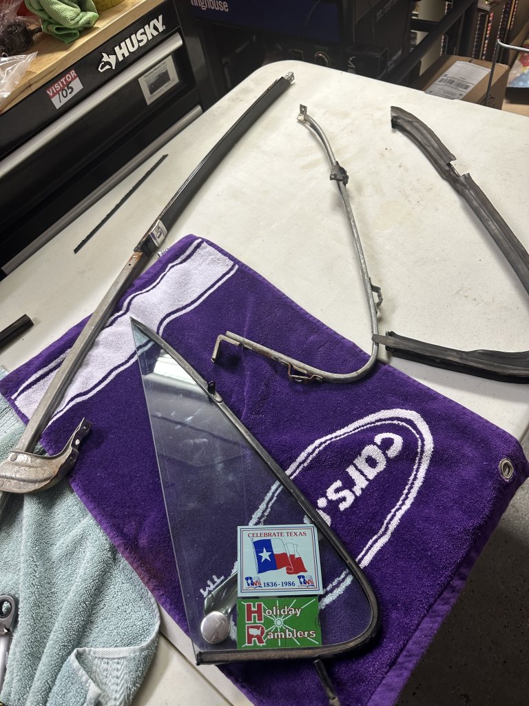

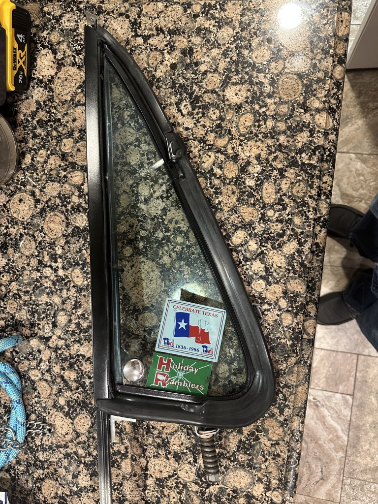

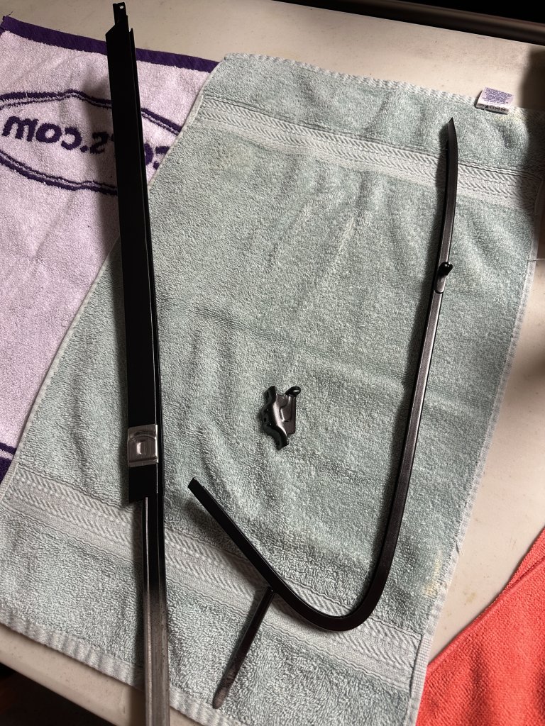

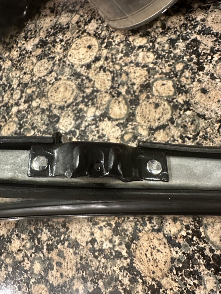

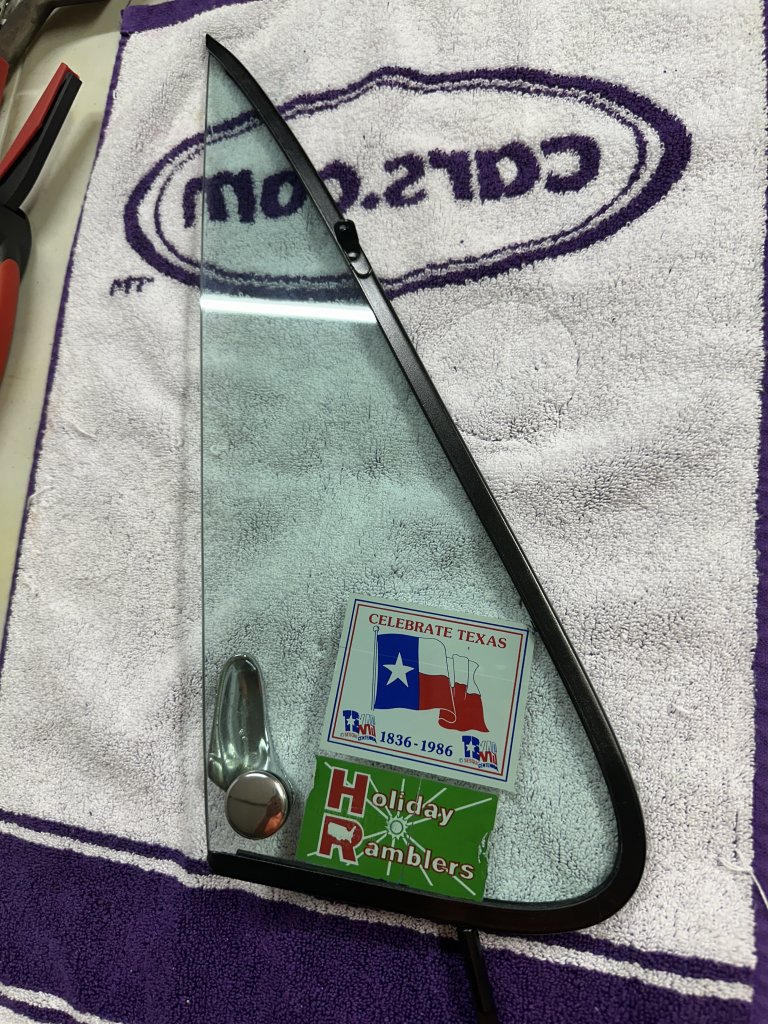

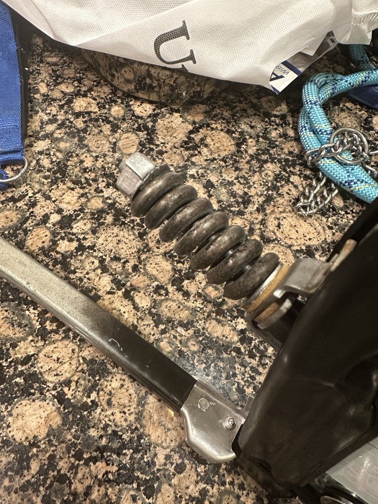

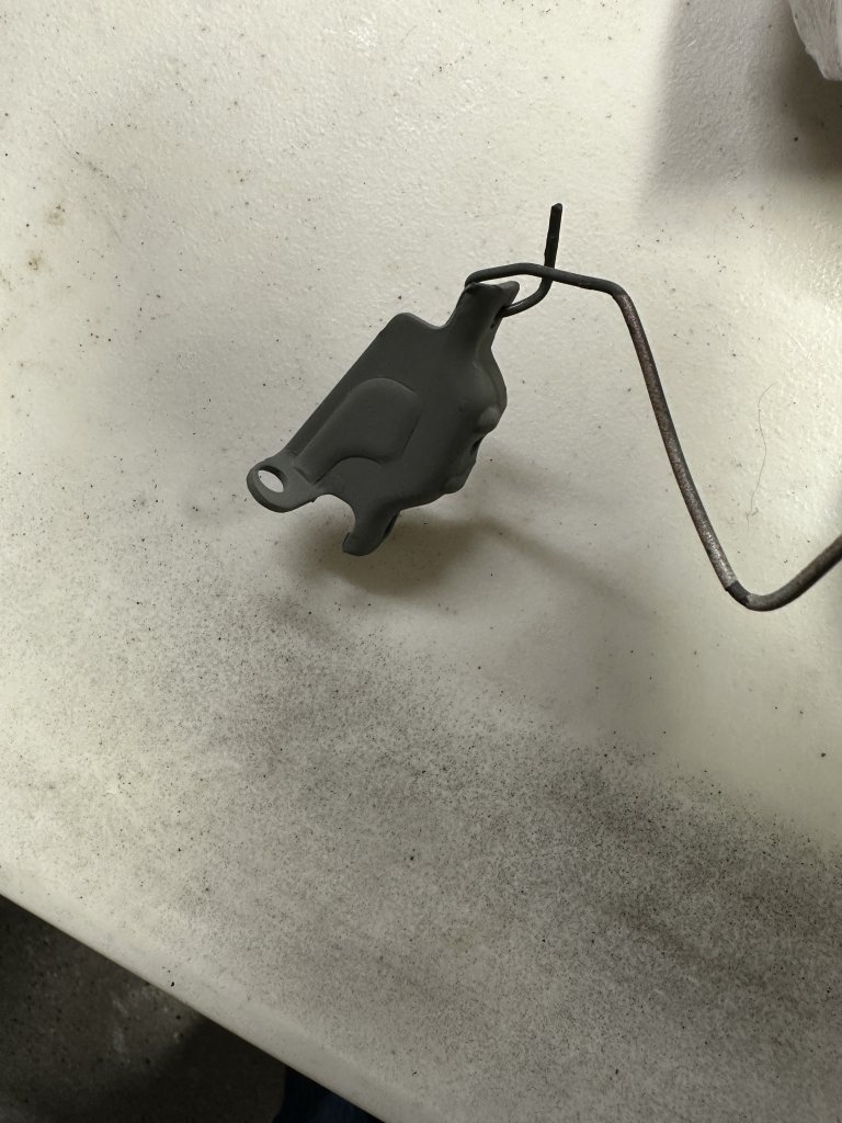

Rebuilt vent window. One down one to go. Was a little nervous about this but went much easier than I thought. Went with precision seals. Completely disassembled, removed vent glass from frame and into the blast cabinet they went after blasting put them in etching primer then semi gloss black. Installing the new seal was a little tedious but as I said went well. Here are a few pics of the process.
