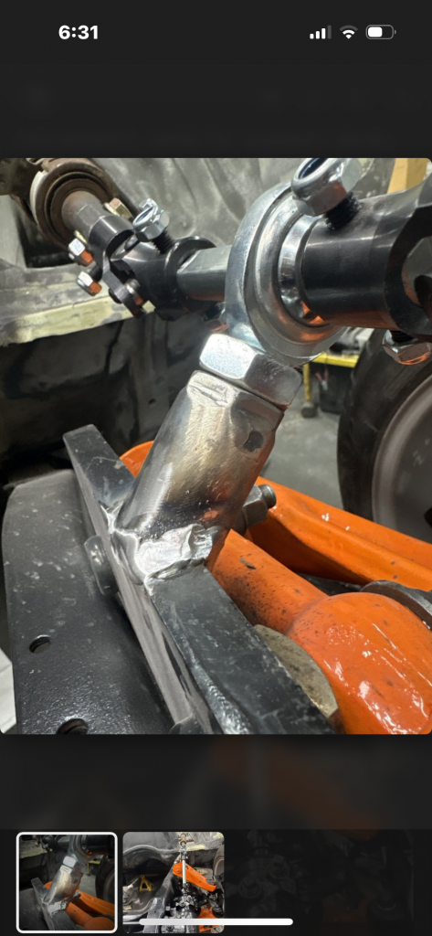

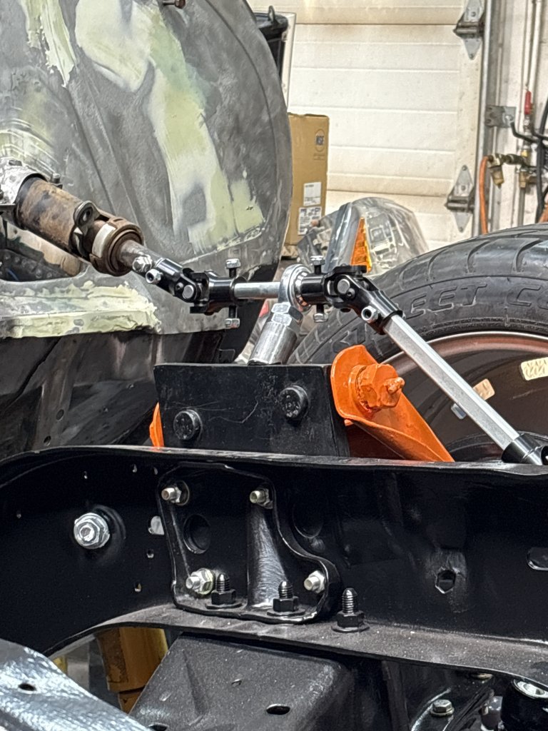

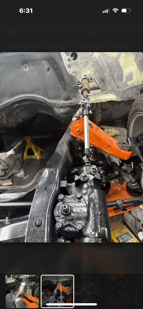

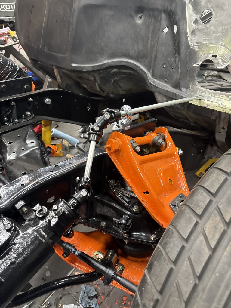

Changed out the double steering joints to singles from my original thought process, gained about 1-5/8” moving the column down by modifying the upper bracket and finalized the steering column shaft stabilization heim joint/column lengths
