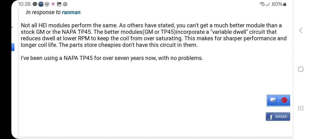

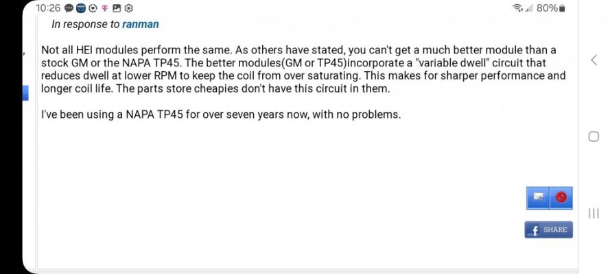

This is why I'll run a used stock module,before I'd run a new aftermarket module. I thought only GM had variable dwell on their modules,but tried to do some research to show instead of just my words. I read about it forever ago about tests between GM and aftermarket modules,but can't find it now.

That’s great information, thanks!

Well I’ll be dipped. I knew I had purchased a Napa spare for the glove box- after I read your post I went and looked and there it is-TP45.
