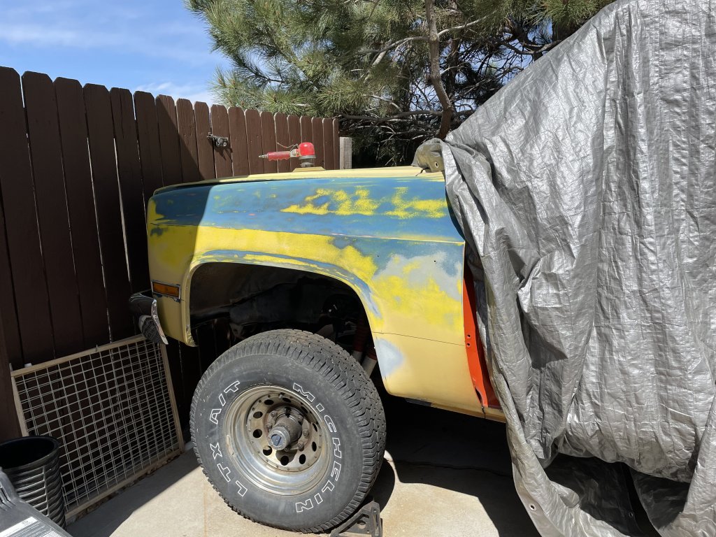

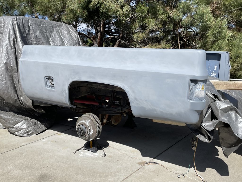

Long board sanded the box in between da sanding the fender to allow the compressor to cool. Paint on fender won’t scrape off like the box paint did so it’s gonna take more time. I also have some rust to repair so I likely will remove the front clip at some point for body work and paint.

Try citristrip from walmart on a spot or 2. Brush the gel on a little thick, then put saran wrap over it so it doesn't dry out. Let it sit over night. Then try to brush/scrape it off.
[edit] if it's verticle, you may have to tape the saran wrap to the body so the gel won't flow off it if you get my drift.

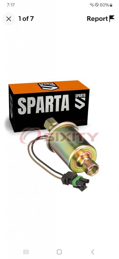

Relocated electric fuel pump to frame and replaced fuel filter on the 6.2 yesterday. New pump was labeled Sparta but it's made by Delphi, it's one of there newer lines but never heard of it.
Balancer is making my pulley wobble so I ordered a new one. and alternator belt will not stop squealing. Alternator pulley will be changed out soon because it's so smooth its incredible, thinking that could be part of it. and when I was at Napa yesterday getting one tested I noticed a box full of new takeoff pulleys so....
