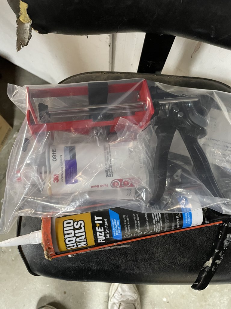

Panel glued, liquid nails and riveted the floor patches in today.
Looks good!
Did you actually use liquid nails or something with better strength properties. Like panel bonding adhesive or similar?
If not, you may want to put in more rivets. Thinking over time, body flexing etc.
Just spitballing here.
I used 3M panel bonding adhesive around the riveted perimeter and used a tube of $12 liquid nails fuse it, almost the entire tube on the inside mating surface and both interior and exterior seams. Hopefully, that’s enough. The drivers side panel was a very tight fit. I considered welding it but figured a lot of extra work for an area that’s not visible.

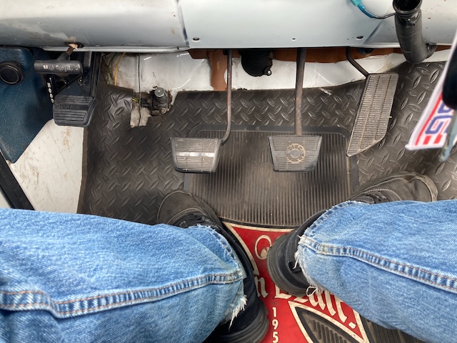

I finally got a rubber pad on the parking brake pedal. Everybody wanted $5.99 for it, but only O'reillys had free shipping to the store. LMC wanted $24 for shipping it. Install was super easy.
