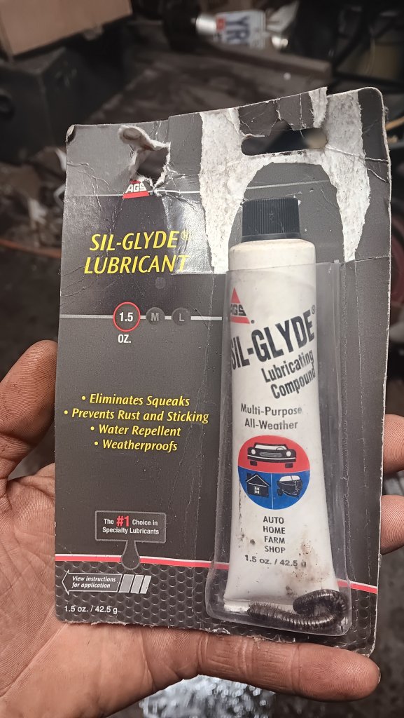

Back in the day.......WAY back.....we used sylglide(SP) in a plastic tube, almost like vaseline. Pull the cable out, clean it and start about 6 inches from the speedo head end and lightly coat it all the way down to the other square end.
Such as this stuff?
They still make the stuff, Napa has their own branded stuff. I primarily use it for the contact points on brake pads. But it works great for a whole slew of other uses too.
Did it last a long time for speedo cable lube? Seems to me like anything that let's dirt and debris stick into it will just gum up a speedo cable later on.
