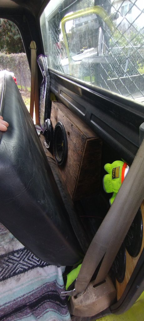

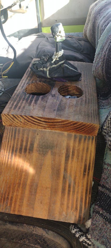

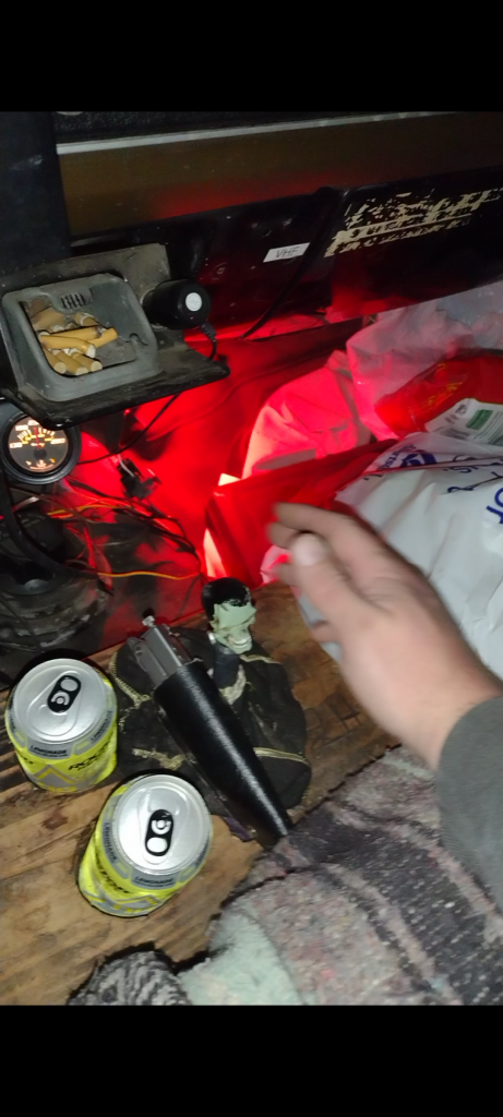

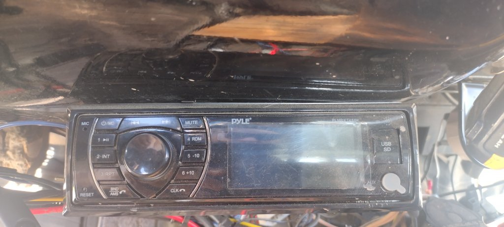

Can't remember if I shared how I setup my temporary (code for permanent) console and speaker setup
@Ajax19 what do you smoke? I just see your ash tray with butts. It's been years since I smoked but I still have vivid dreams where I am smoking and wake up wanting one. Also enjoy the smell of a lit cig from time to time. Me: Camel lights then eventually Winston lights...because I wanted to get the beer and the cigs every day after work lol .
