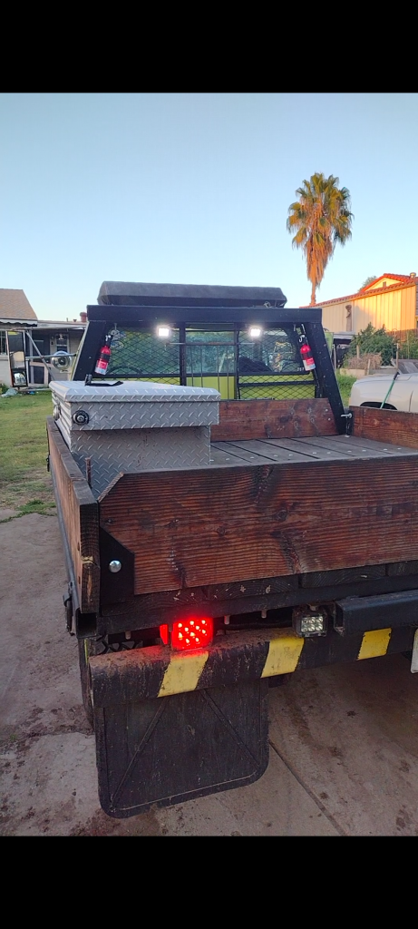

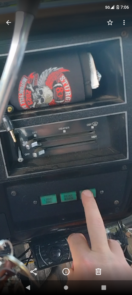

Added rear deck lights to the head ache rack was able to use a switch already wired from it's fire truck days you can also see how I fixed my fan switch haha
