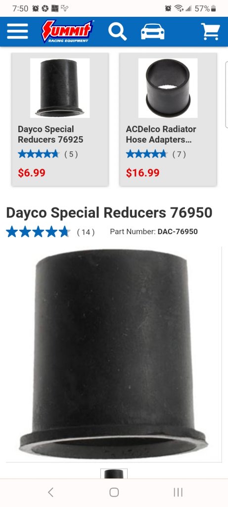

Follow up, 2 different radiators. One has 1 1/2” - 1 3/4”the other 1 1/4” - 1 1/2”. Both listed for a ‘84 C10, 305 automatic. Was unaware and ordered the wrong radiator, said that it fit.
argh….. so I was wondering if instead of exchanging the radiator if the hoses could be ordered in the corresponding size???
10,175
19,682
Well with info you've given I don't know if you ordered a radiator with too small fittings or too large fittings. If what you got is too small they make spacers the resemble a 1 inch wide rubber band you put on the nipple and then put on the hose.
