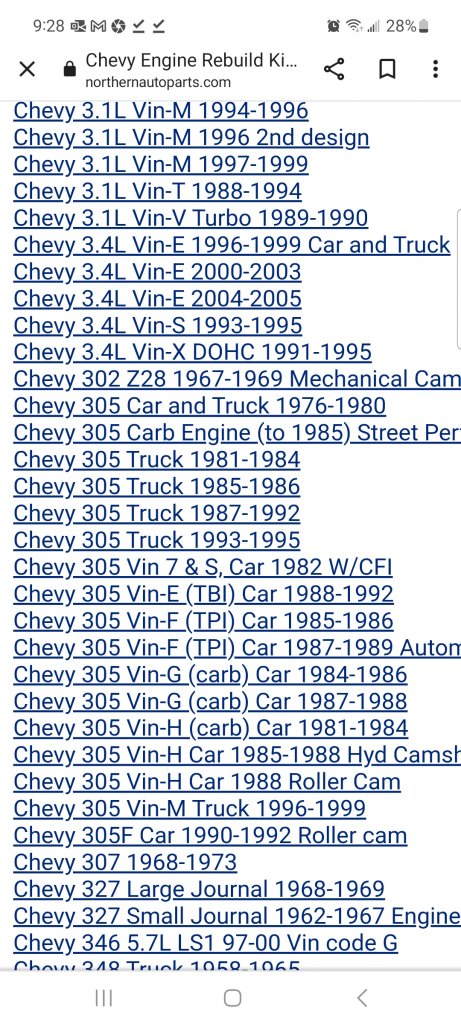

Look at what I found today,this deal with why do some trucks do fine without esc and others don't is really bothering me.Someplaces list a 305 c10 engine kit 81-84 but nothing 85 up, then I found this that shows a different kit 85,86 and another 87 up. Possibly just a different gasket set but I'd think if that was the only change everyone would list 85 up kits IDK things that make you go hmmm.
