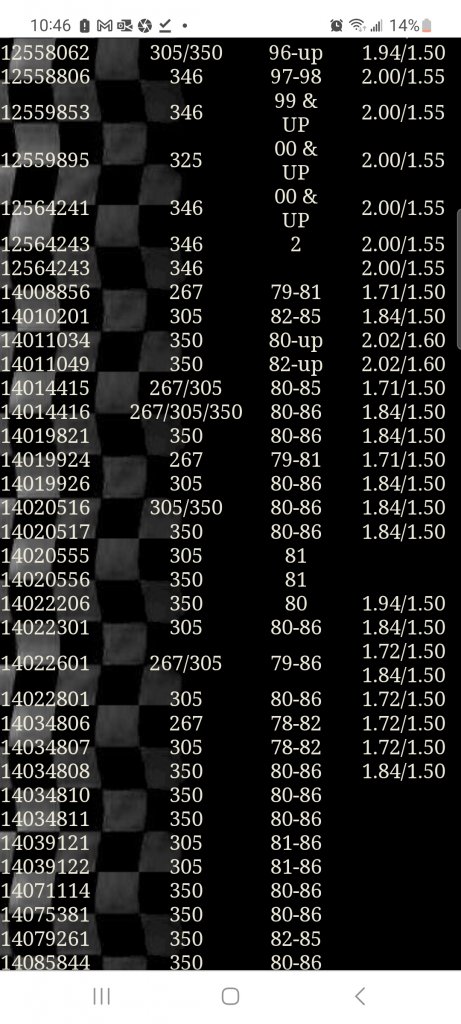

Look at what I found today,this deal with why do some trucks do fine without esc and others don't is really bothering me.Someplaces list a 305 c10 engine kit 81-84 but nothing 85 up, then I found this that shows a different kit 85,86 and another 87 up. Possibly just a different gasket set but I'd think if that was the only change everyone would list 85 up kits IDK things that make you go hmmm.
Hey Rick, did the ESC 305 heads have larger valves?
6,929
11,925
-Archimedes. This is a quote even older than me.
Look at the 301-807 castings,that tells me yes the there were different valve sizes,I just don't know what years and engine codes got which heads that's not an entire list of 305 heads either. So another part of the mystery maybe all the esc 305s don't have the same heads. @Turbo4whl sorry forgot to attach the pic.

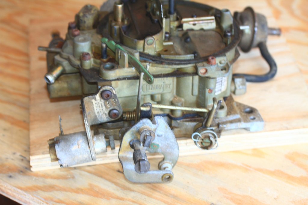

@Matt69olds , There is a choke pull-off, you can see it bottom left of this pic. I replaced it when I did the rebuild. I've seen that some have one on the front as well, but this one only has the one. I am going to try to keep the Qjet, I really do not want to send it off, and have know idea where to send it any way, so I will be attempting a second rebuild.

@Rusty Nail Transmission cooler is definitely a must, than you for the brand recommendation. As to the missing screws that really puzzles me, if I remember correctly, the instructions mention 13 airhorn screws, and I had all of those, but why those holes are there is beyond me. I am going to go ahead and post the pictures I took during my rebuild, maybe ya'll will see something that I missed, or did wrong. I really hated putting the silicone on there, but it was seeping fuel pretty bad, how do I go about flatting it without cracking the casting? I will keep a sharp eye on that rubber fuel hose until I get a new steel one bent up.
Any way here are some of the pics.
In the one above you can see the hole in question, and the screw that is there
The little clip that lifts the needle, was inserted through the hole as you see it. The instructions said to hang it over the edge NOT through the hole so I guess someone at some point had this open and put it back wrong?

@Ellie Niner That is exactly what appears to have happened. It was only leaking right around the solenoid where the casting is super thin. How did you flatten Yours?
