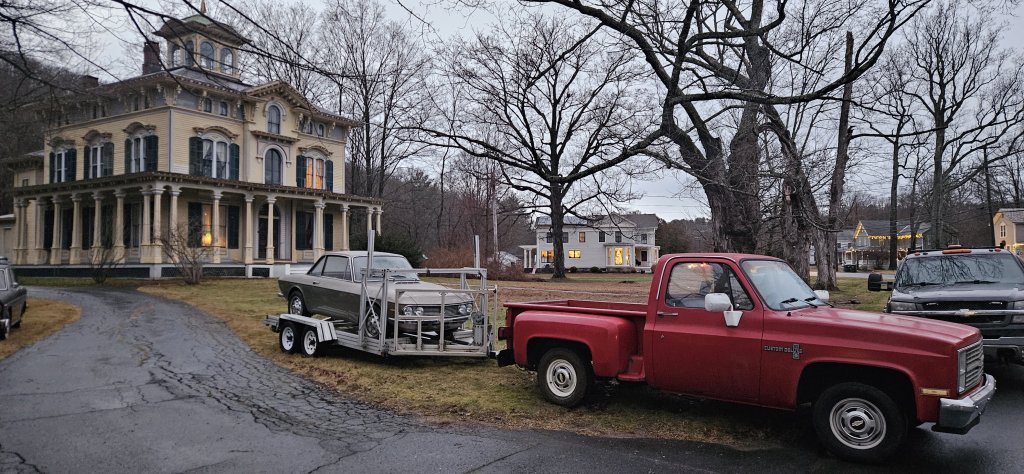

Yesterday towing in my 305 C10 with functioning ESC ignition, 2.73 2wd, 4 speed overdrive new process transmission. It worked great!

Thank you @overdrivestepside ! I really appreciate it. How much do you think that load weighs?

The package was about 3500 lbs.
