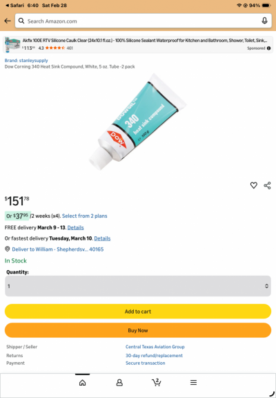

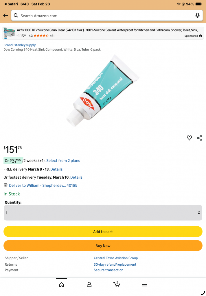

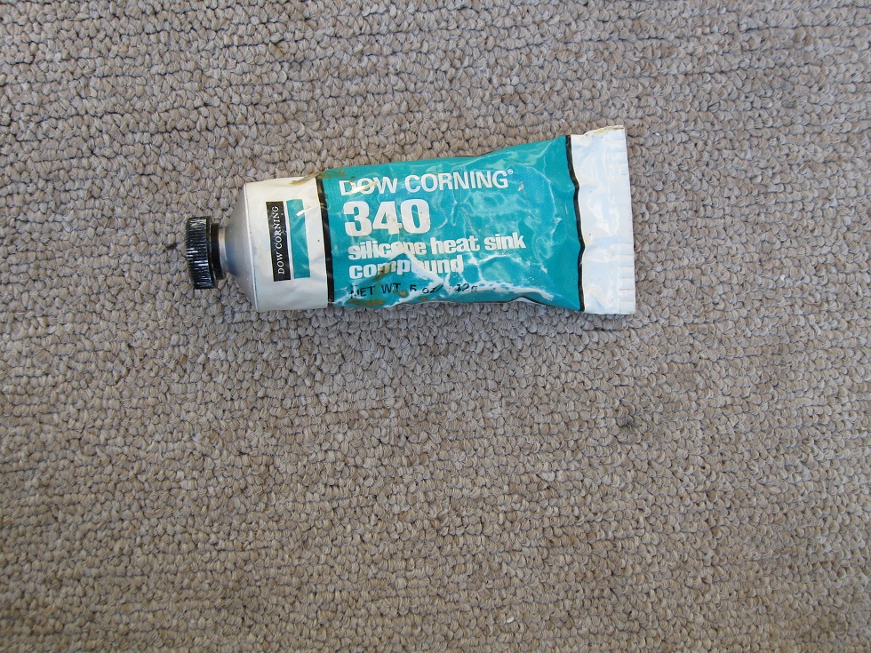

Arctic Silver is a tad cheeper.
True but I build a lot of custom systems some water cooled, and a lot of those parts just come with the grizzly. I haven't purchased thermal past in probably 10-15 years and probably have 20-30 of those little tubes in my tool kit.
