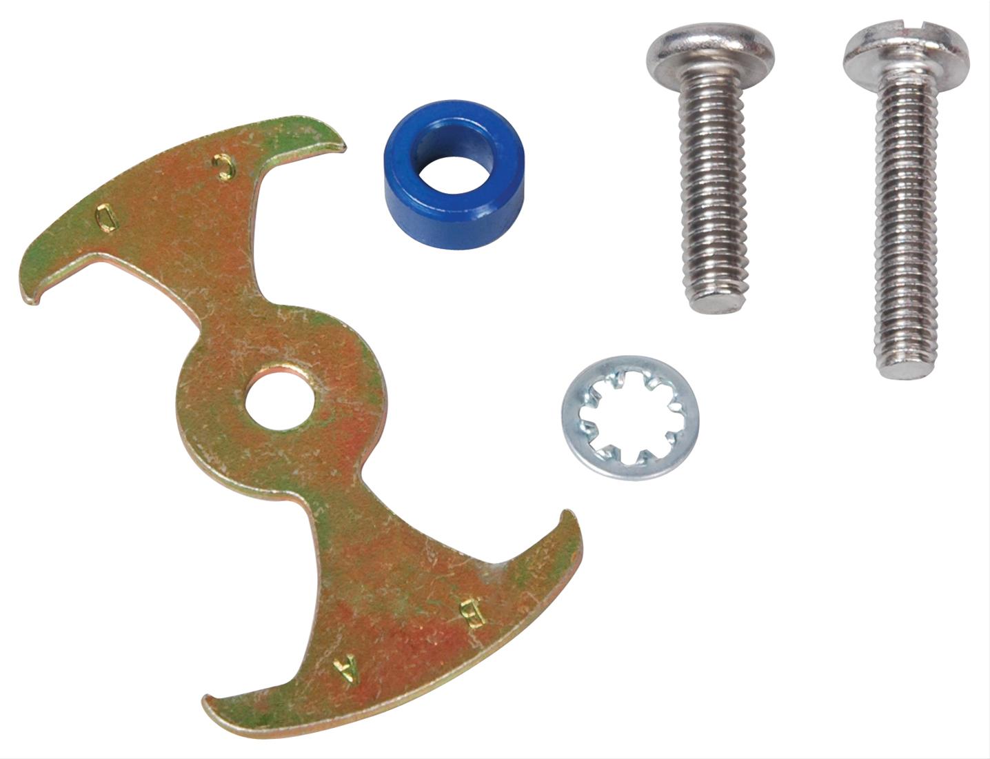

Get a timing light, make sure the advance weight holes aren't worn, use manifold vacuum and limit the vacuum advance, it's just another SBC. Crane no longer makes the advance limiter kit, but MSD makes one that easy to install. Both my vehicles are set up this way. I wouldn't tow a lot with one of these 1/2 tons without trailer brakes and a minimum 3.73 gears. Just my opinion.
