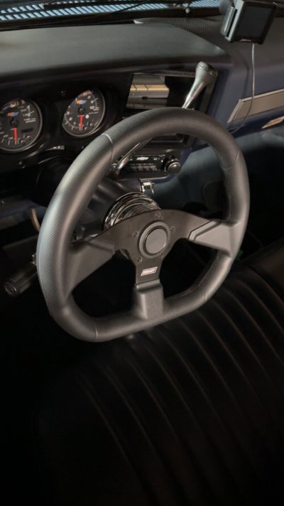

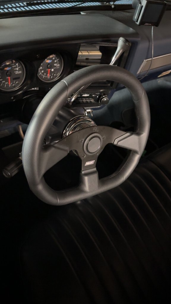

I felt the same way with the factory wheel and a new bench, I could barely slide under the seat. After trying a autozone chrome 3 spoke I decided to give this Gran 689 a try. Far more room for legs, but with the adapter its only maybe a inch more room than the factory wheel. I am also contemplating the syndicate shorter column but for this summer, this will do just fine

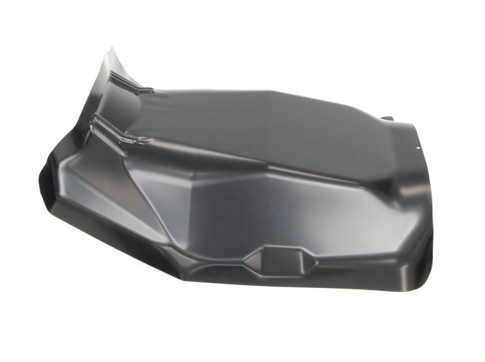

Side bar.... What's the "Coming Soon" trans tunnel thing? Inquiring minds want to know. :Big Laugh:
7,057
26,376
That's an olddddd picture, that was the prototype for our "high hump" for '84-up trucks. We now have the '67-72 high hump, '73-80 2wd high hump '73-80 4wd high hump and rear piece and the '84-up high hump.

Will the 84-up humps be made with the t-case shifter holes and mounting rings for the 208? I looked at them last year when they came out but that is what is holding me off buying one. If I have to put my t case mount in one, and then install it in my cab, it may not be worth the effort.

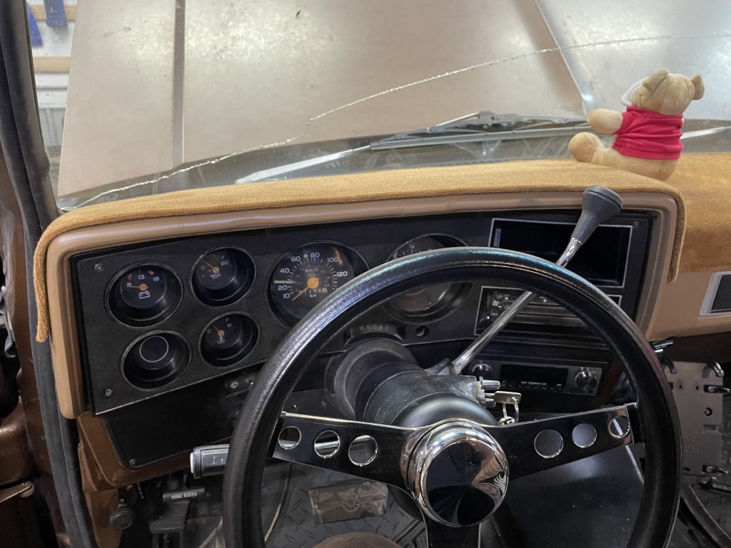

I installed a Grant shallow-dish and small wheel. It did require their adapter, but it installs easily. This is a match to what I had in my high school truck

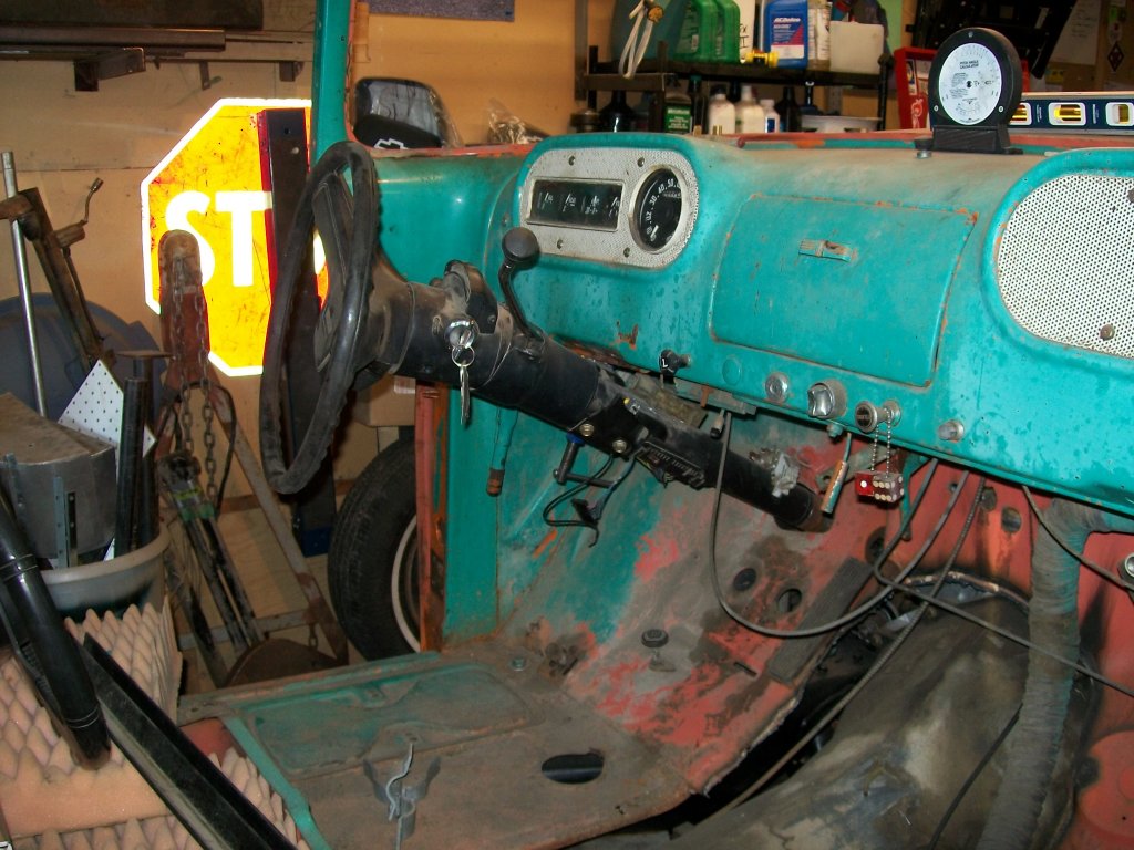

We also installed a late 80s/early 90s Blazer steering column in a '55 Dodge 1/2 ton, so anything is possible. It was on an '88 S10 frame, so the steering linked up easily.

Nope, these are intended as a universal thing for anyone to modify as they see fit. The idea was this will work for anyone adding a modern, larger OD transmission, larger stick shift trans, different Tcase/doublers/etc. That way the customer can start with a blank canvas and modify as they need, the main thing here is getting more clearance
