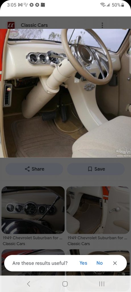

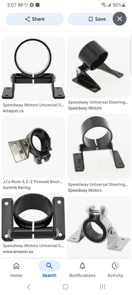

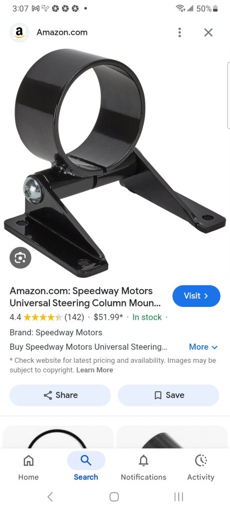

Or you can just shorten your own,install an S10 column or relocate your existing column,all of those options are cheap. I'd have made or modified my mount by now . Even as simple as an exhaust clamp clamping a plate to the column and drilling the plate for the factory mounting bolts
