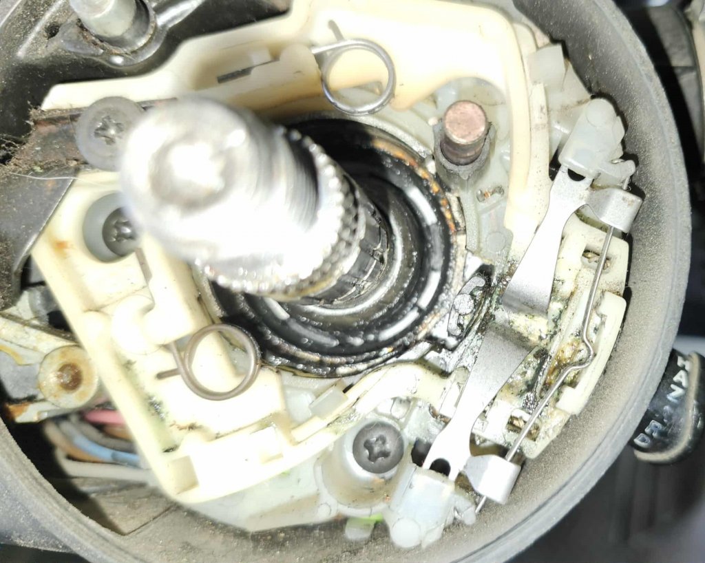

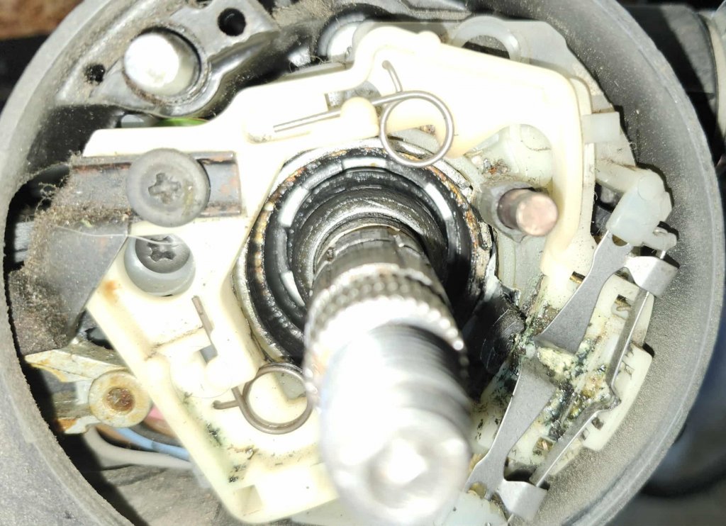

I tore back into it today, and the inner race WAS missing. Whoever took it apart prior to me must have just missed that piece in reassembly. I reused the outer bearing, but replaced the plastic retainer, ball bearings, and inner race with the new GM bearing parts. Put everything back together and the play is completely gone! I also replaced the turn signal cam while I was in there, since I didn't replace that last time (just did the blinker switch and multi-function switch/rod before). Thanks again to all who posted information - very happy to have this fixed now.

I seem to be missing the little clip that goes in front of the steering wheel nut. Is that to keep the nut from backing off? How important is that? And does anyone know of a part number or a place online that I could buy a replacement?
