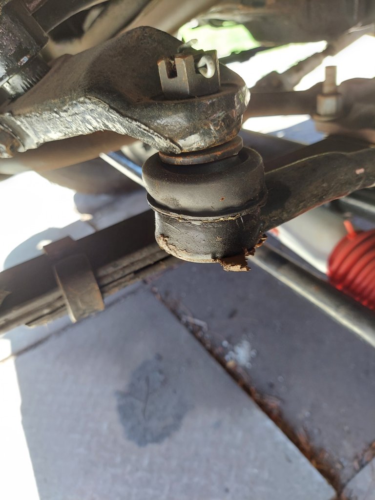

I had the problem there was too much play in the steering wheel turning right especially. I changed my tie-rods that create the drag link that attaches to the pitman arm. This oozed out the dry grease in there and decided to do it now. But the biggest change I found was adjusting the worm gear on the Saginaw steering box. I used a performance spanner wrench (part# W30781) and just doing that helped aligned the steering wheel proper! I have yet to test it but I'm looking forward to it!

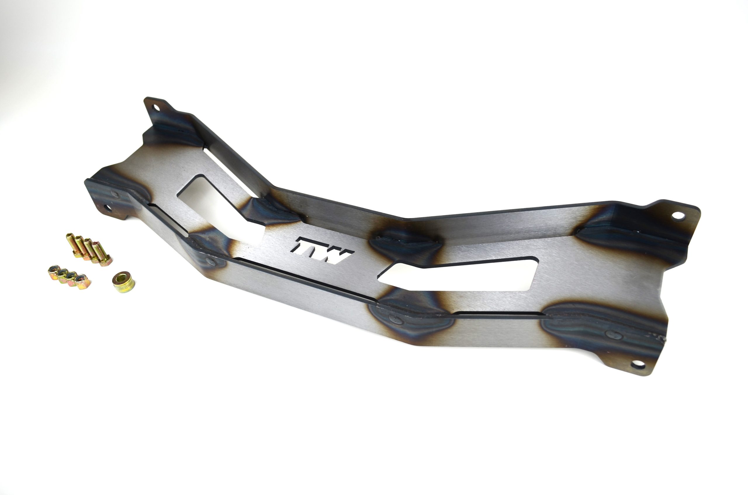

Does anyone offer a beefier crossmember.....where the prop valve is? I'm not seeing it anywhere. I'm in if there is one.
Hell I'd like a a mini I beam across the sh|t and get done.
TinWorks does, I plan to add it to my truck along with the suspension goodies

wow, thanks dude. Sent them an email and will go from there. At that price if I have to grind one rivet and it's better, why not.

Agreed. I was originally just gonna weld in a tube but for that price and I can keep the OEM+ look? Yes please

Not worth it unless you want the wow factor. The problem with the front cross member is that they are riveted. Remove the rivets and drill it out to 7/16(IIRC), install good grade 8 hardware and it gets much stiffer. Also the bumper needs to be aligned and tight.
If running large wheels or spirited driving the truck..the ORD or Autofab brace as well as the ridetech braces will remove any flex in the front frame. The Autofab/ ORD style braces reinforce the back bolts of steering box and Ridetech reinforces the front bolts and triangulates the front rails, both sides.

Absolutely worth it over the flimsy '81-up 2wd version. My rivets are tight, it was the actual crossmember flexing. So this new one will get bolted in with the larger hardware. I might add in the Ridetech triangulation brackets as well, we'll see.

They don't have one for 4x4 yet. I got the email this morning from them, they said they are working on it.

I'd just push a piece of 6 in channel iron up against the frame rails in front of the sway bar drill 3 holes per side bolt it up, it would hold the frame rails parallel you could get fancier but that would add a ton of ridgity,cheap and easy. 6x2 channel 3/16ths

Wow, didn't know they were that flexy those years! I'll have to take a closer look at one next time I see. I was actually going to use the later rear crossmember at the tail of the bed on my 77 as I figured the holes would create some additional access that I could have used.
