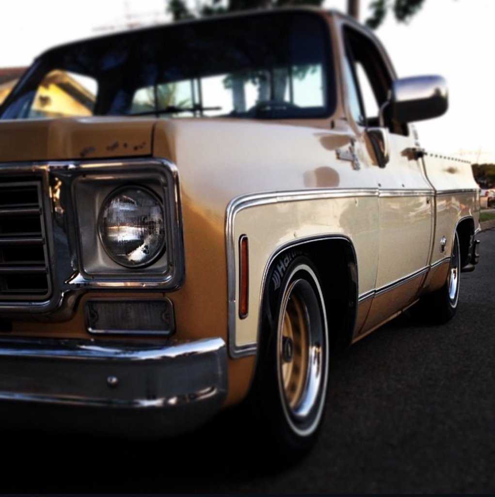

Jay
76 Big 10 with around 5.5/ 7 drop

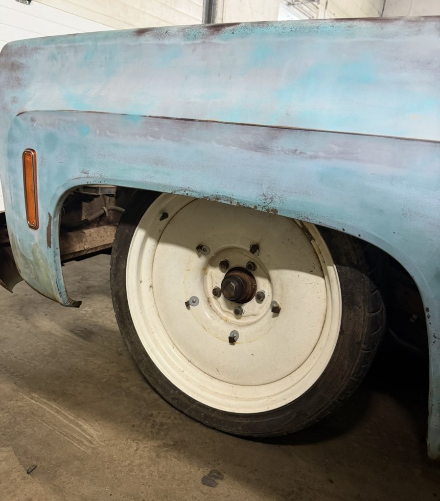

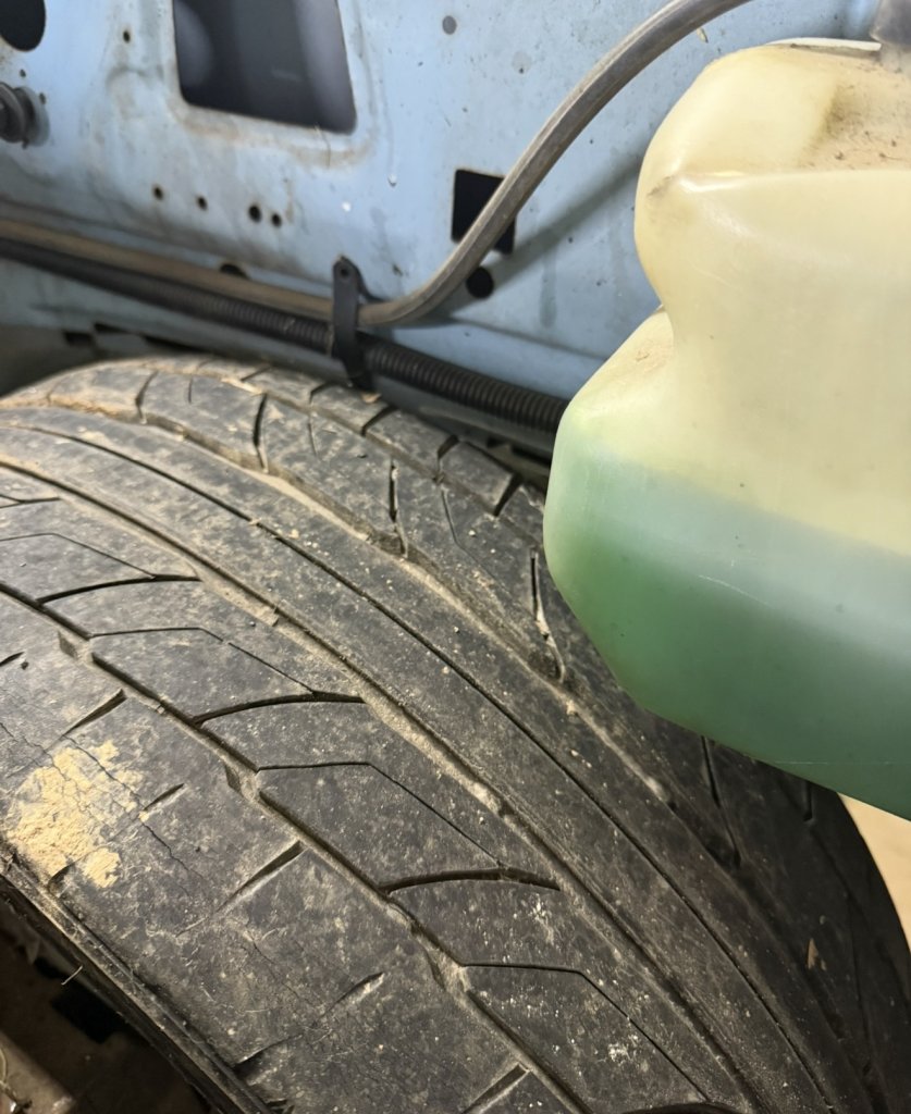

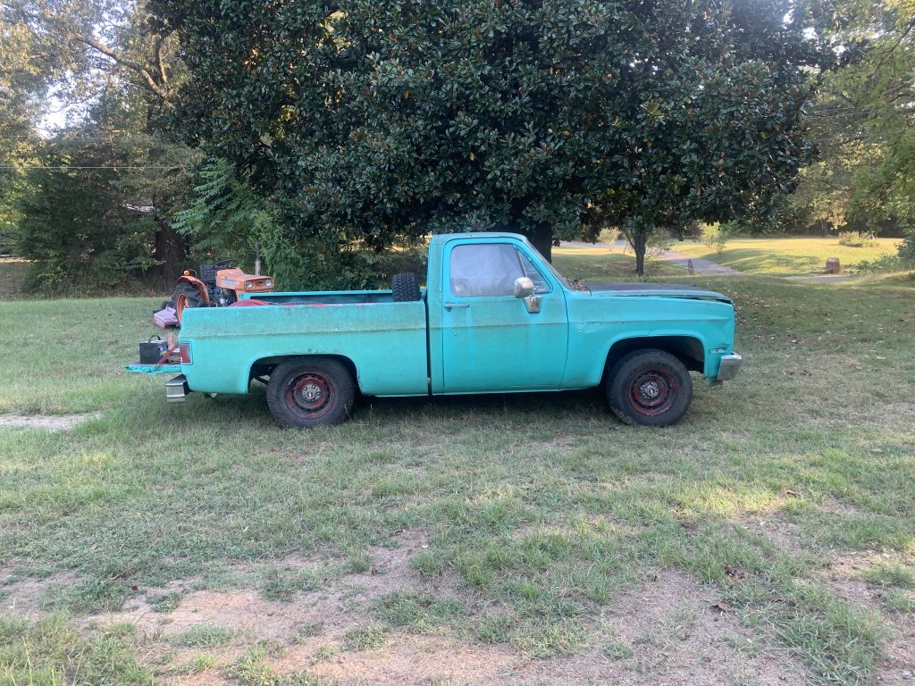

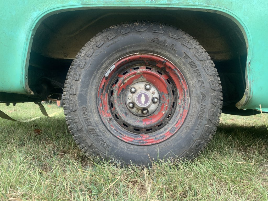

Has 235/75r15s on 15x6 f/r. Rear sat 3” higher than the front is in the pic, so, a bunch of drop. Rear flip and shock extenders, Gabriel 500# rear load assist shocks that need new bushings.
Front still needs lowering spindles and drop/cut springs. Thinking 3” spindles, 2.5-3” springs and 215/70s if the 235/75s are too big. If it then needs thbular control arms, so be it. Wife’s truck, I can’t stand 2wd.
Rear shot is the clearance, no notch yet, with a 235/75r15 AT. Will be on 30-9.5r15 HTs. Plan to dump the tired 2wd 3+1 springs for much newer 4wd 4+1s. Bolt in notch with smaller jounce bumper come warmer weather, truck is too wide for the garage (1920s built).

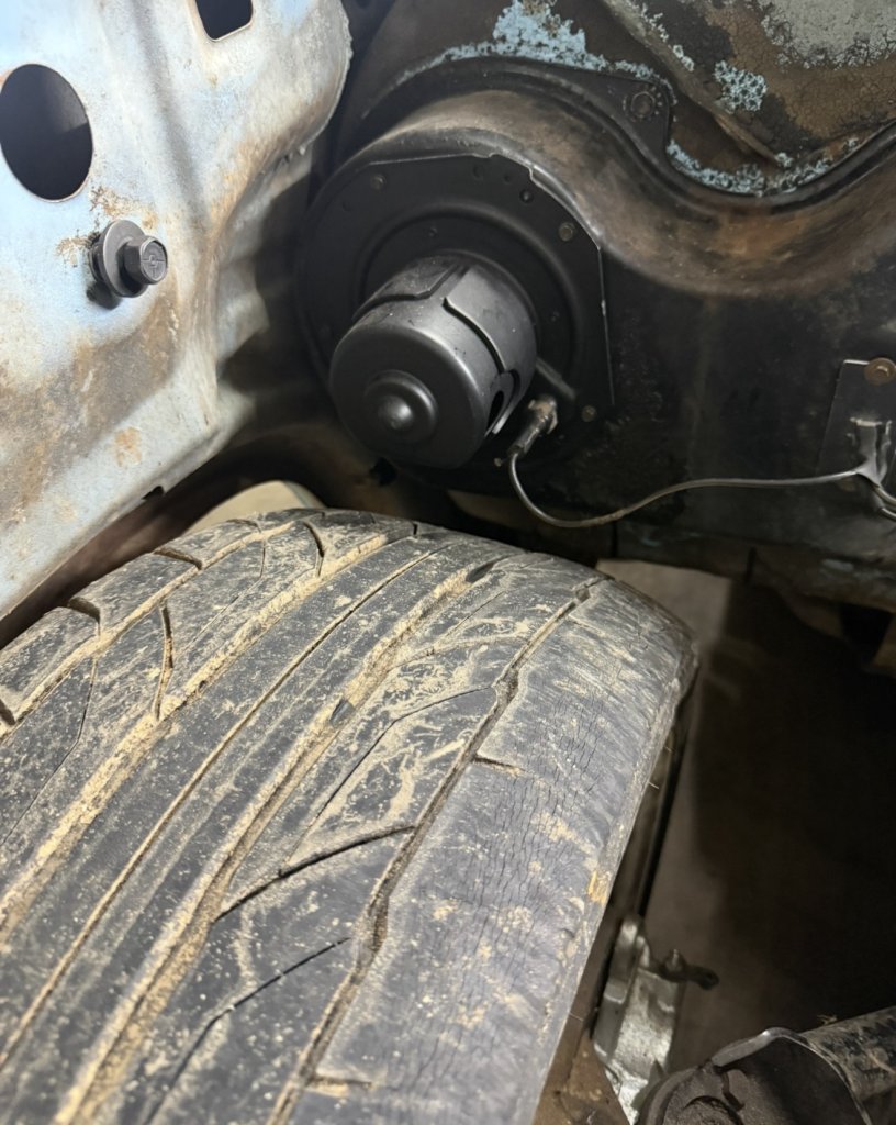

So unless I want to delete and shave some stuff. Doesn’t look like I’m getting much lower
