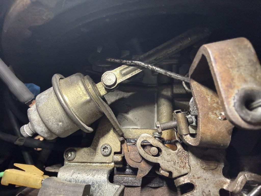

Ok sweet! I just wanted to make sure! Yea I knew they would drop, it just seems like it’s a bit too much still. Just gotta figure out how to adjust that

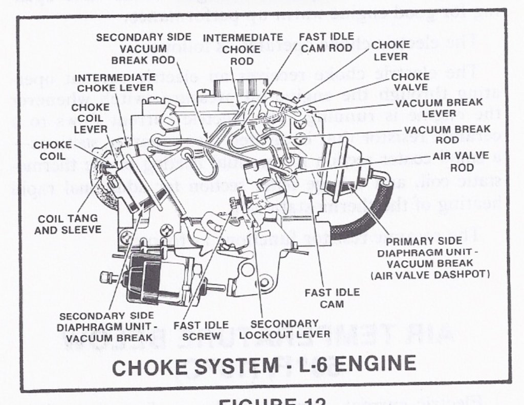

The fast idle screw will be the last thing you adjust. When you go to start a totally cold engine, you should press the throttle pedal all the way to the floor once and then let it up. This should allow the choke to pull shut and the fast idle screw will then rest on the fast idle cam as shown in the diagram. That is when you adjust that screw to achieve ~900RPM when it first starts, which will then climb to ~1200-144RPM as it fully warms. Once fully warmed, a quick tap of the throttle will let the fast idle cam drop down and the throttle will then be resting on the regular idle screw.
I highly recommend tuning the carb with a tachometer and timing light rather than a vacuum gauge if you can find one. You tune the carb for peak RPM and then lean it 50-150RPM from peak for best idle mixture. That will correlate pretty close to peak vacuum as well.
That makes total sense! Thank you! Yea I didn’t want to mess with it just happened to notice when I took the picture! I need to get a tach, got the timing light though! Making sure this carb is dialed in is my next step!

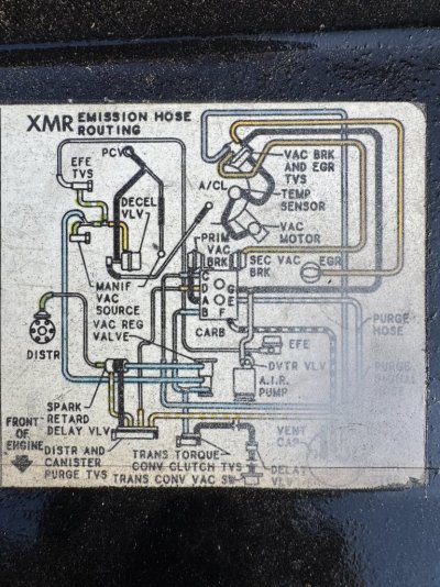

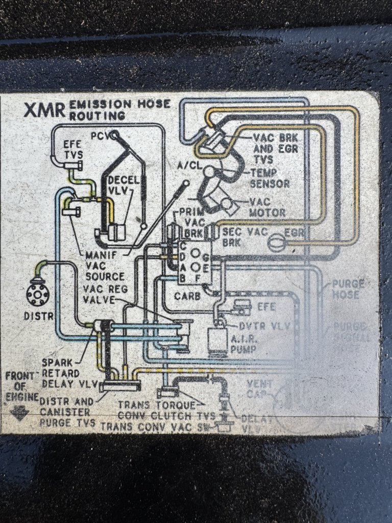

Good job! If your truck still has the emission decal by the radiator, please take a picture of it and post it. There are others looking for that model emission diagram. thanks.

Did you post it up in the thread with the labels. If not, please do, and make sure to tag a moderator so they can add a link to the first post, showing it in the list.

thanks for posting that XMR emissions diagram. I stand corrected, yours is twice as complicated as my '81, you even have an air injector pump.
