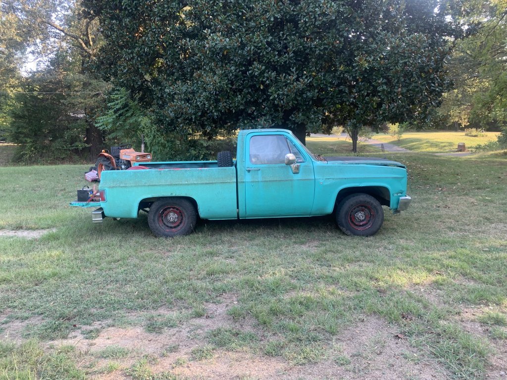

Ralph with flip kit, shock extenders, no notch (yet), Gabriel Load Assist shocks on all 4 corners and 40 year old factory spring bushings. Once the new Energy Suspension bushing kit and shock eye bushings are installed, will re-evaluate whether he stays this low or not. Came down 8-9” versus springs over w/o shock extenders.
YMMV/YRMV
Will likely be swapping in 1992 K1500 rear spring packs. Considerably stronger than C10 springs. Truck will be sporting an era correct aluminum topper. Wife’s physical therapy runs, grocery runs, light (for her) camping trips. Has double the fuel economy of my 350/NV4500 K3500 dually…
