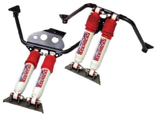

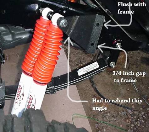

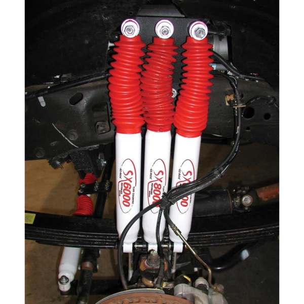

One idea you might look at since you mention a stepping stone to coilovers is mounting a 2.5" coilover shock but not using the coil mounting hardware. This can get you to a point that linking the truck and using the shock as a coilover is that much easier. Coilovers are just a 2.5" shock with mounting hardware so they can absolutely be used by themselves. That said, the mounting is going to be a lot more complicated than a bolt on dual shock setup but when you're done you've done a lot of the hard work involved in a coilover swap. If that's the direction you're leaning, it's a great way to start.
