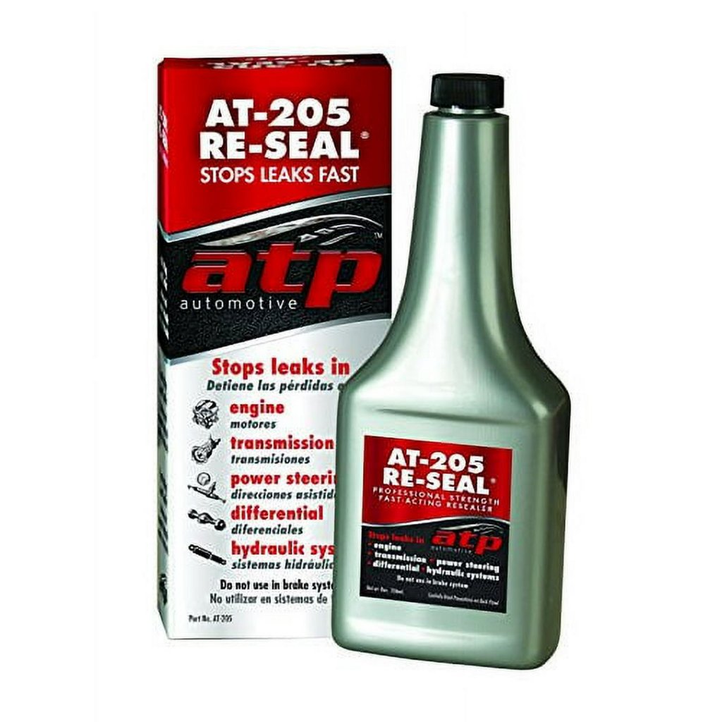

Speedi Sleeve on the old axle? Reuse the old seal ? Seems like a lot of work for a bandaid but not sure how to beat a leak without a reseal. I guess no one makes a diff stop leak product. :anitoof:
Chevy 88
Mar 28, 2025
783
792
Canada
f7t6
GMC
For a stop leak, they do make this - and its a fantastic product that usually works very well. But not in this case.
